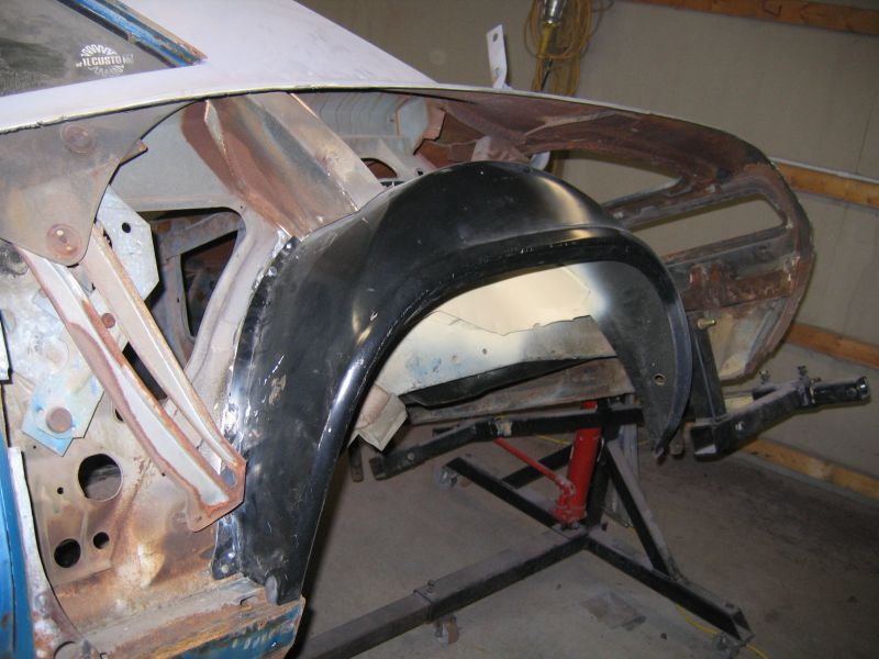

I used clamps and small nuts and bolts to pull the new wheelhouses in tight to the old inners. I also cut out the whole outer all the way to the inner at the factory seam.
Attached Thumbnails Outer Wheelhouse replacement-wheelhouse.jpg   Outer Wheelhouse replacement-wheelhouse2.jpg
