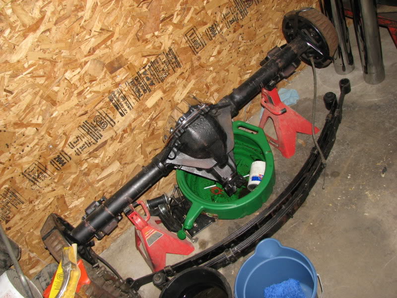

i have a freshly redone 3:31 12 bolt posi with new lines,shoes,hardware,seals with factory eaton series 3 posi and all new multi leaf springs,bushing,shackles,shock plate from a 69 ss for 1600 cash, its basicly everything you need to swap out from your 10 bolt to a 12 bolt
it has a new heavy duty aluminum cover and i have the steel factory one as well.
