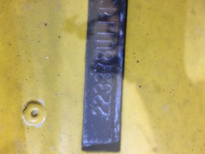

Default Vin pictures,
Vin pic, I was hoping to get back into Chevys but this vin issue has me worried, that and the cheap back half conversion.

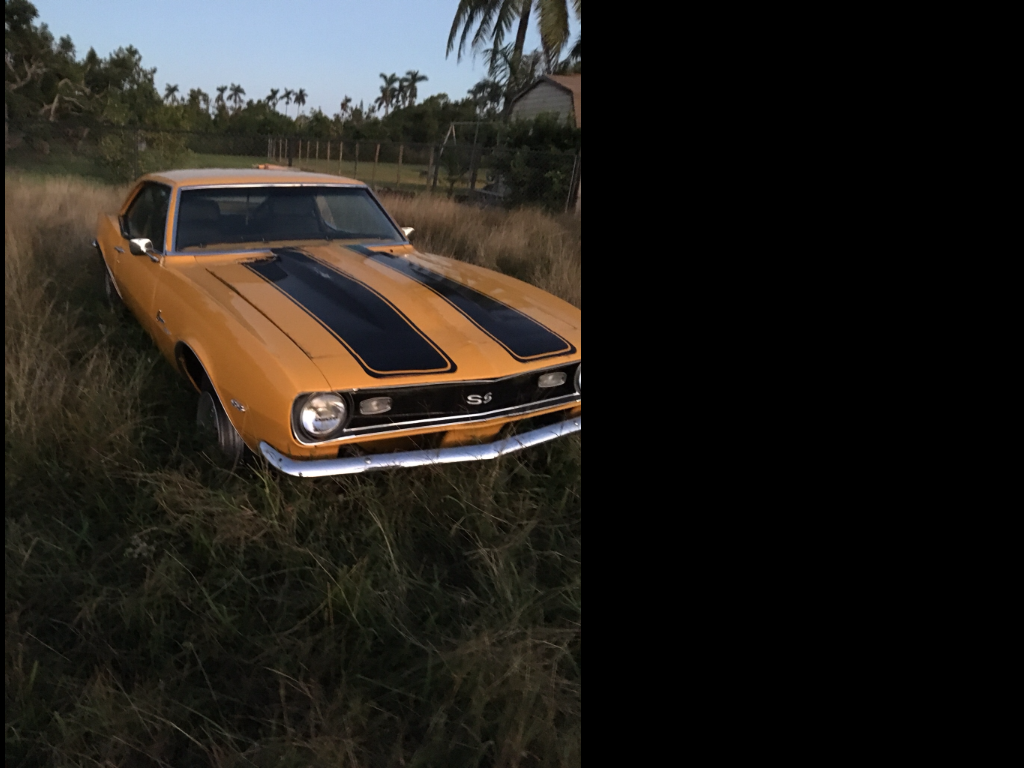

Default Car picture
car picture

Default Vin pic
vin picture
Old Dec 5, 2017 | 09:34 AM
Everett#2390's Avatar
Joined: Oct 2012
Posts: 2,595
From: Va. Beach, VA
Run, Forrest, run
You are seeing a 68 Camaro born/starting life as a 68 Firebird.
Decode 1st Gen Firebird VIN - Trans Am World
