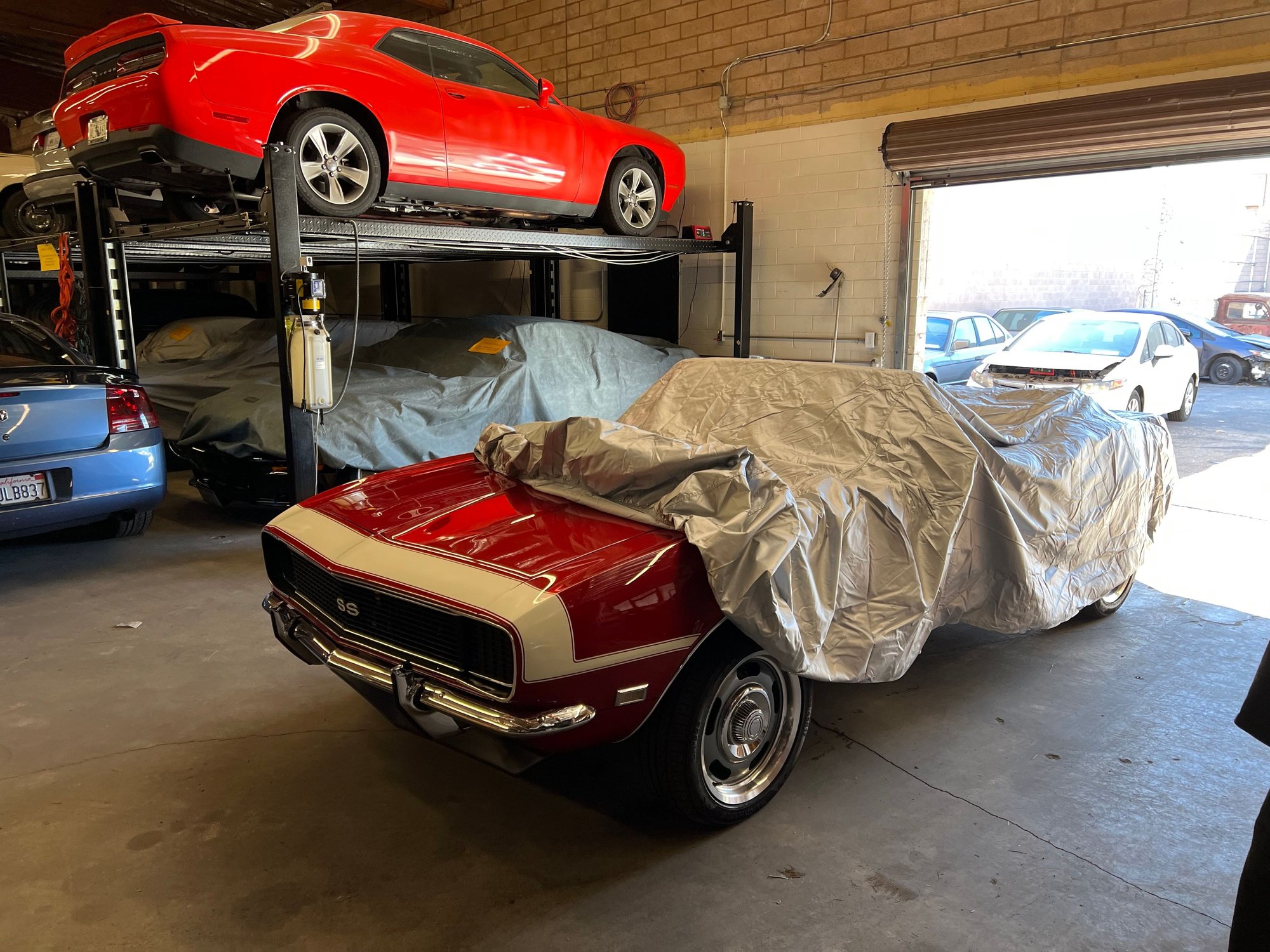

Thanks, Chris. I agree with you. We will be welding in subframe connectors (probably Hotchkis), and the newer style cross brace. I think she will be plenty strong. Will definitely post pics as we get to putting it back together. Just a little mystery now as she went into storage for a few weeks as we build.
