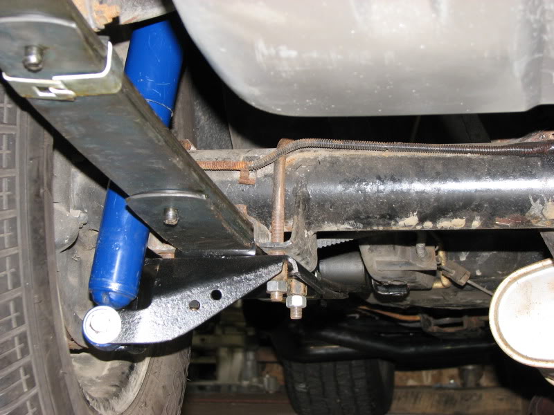

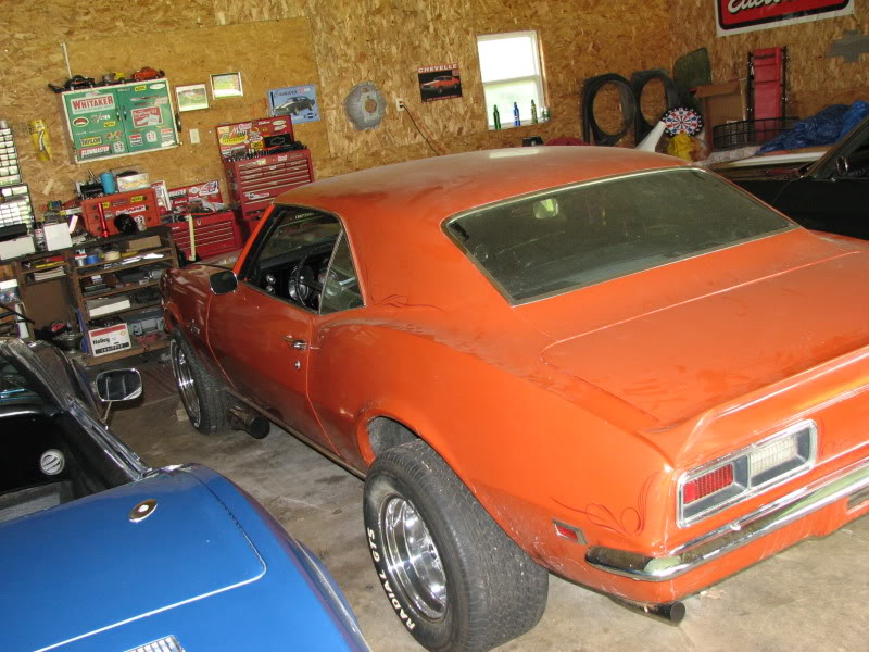

update removed the top pad to set the spring deeper in the perch and got shock installed!!

Old Jun 14, 2011 | 01:31 AM
wantvegas's Avatar
Joined: Mar 2011
Posts: 31
From: Sacramento,ca
Looks good man! I like your garage!

hay, yah looks like the camaro needs some attention. come on now its almost summer. or is that spring. is that a cutout pipe i see there? video man, come on i want to hear it better yet see it at night.

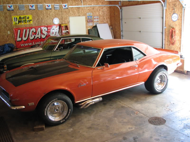

its acctually a sidepipe i havent got hooked up yet, was waiting to finish the springs. heres a pic of the other side

Originally Posted by burnt68
Burnt68 – The rubber pads are to help reduce some of the road and driveline shock to the spring…and then into the body. Many people simply remove the isolator pads and fill the gap (if there is a gap) with aluminum shims. This also helps the chassis react faster when racing.
Do those springs have a pin-bolt that sticks up to hold the spring pack together?
Nice side-pipes! We haven’t seen those in ages. Where did you find them?

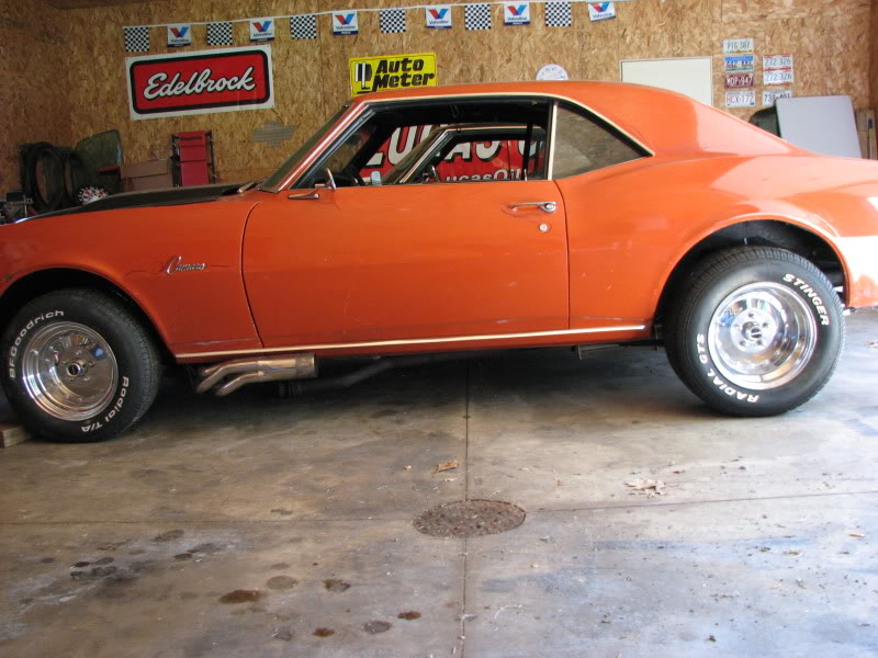

Yes there is a pin in the spring that gose through the lower shock plate. i removed the upper pad and it sits pretty tight now.
found the headers and sidepipes on craigslist complete and new never used.

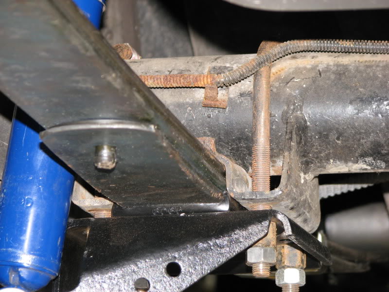

Burnt68 – so the pin doesn’t stick out on the top of the spring? It must be flush with the top of the spring. The rear spring installation looks much better now. Some people go the extra mile and put a few washers or a shim between the lower shock plate and spring perch to keep the plate from bending. In some applications, that gap is more than ˝”. You’re doesn’t look that big.

yep traded the guy 4 ansen sprint slots(50 bucks off craiglist) and 200 cash for the headers and pipes!!
pics after complete install of rear springs
