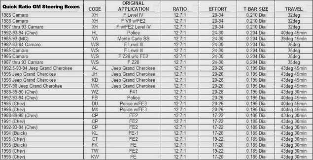

You're right on the 84-87 IROC box... tough to find but perhaps the best. But here's Dave Pozzi's chart on whats compatible and the relative specs:
The JGC box is in and I did do all the other mods; Helix upper and lower tubular control arms, Hotchkis 2" drop springs, ProForged tie rods, tie rod ends, All new bearings and bushings, ProForged balljoints (used the "tall" upper balljoints for better handling camber options), Wilwood Calipers with CPP slotted/vented discks, TuffStuff dual-diaphragm power booster, and the last item is going in Tuesday... a Helwig 1.125" front sway bar.
Even with the puny stock 5/8" front bar the handling and steering is like night and day. With the big bar up front, she should corner flat as a pancake. Steering response is incredible compared to the old power steering box. No more wandering, nibbling... its plenty quick for me. And the best thing? That steering box cost me $45! I'll post a detailed thread on it.
