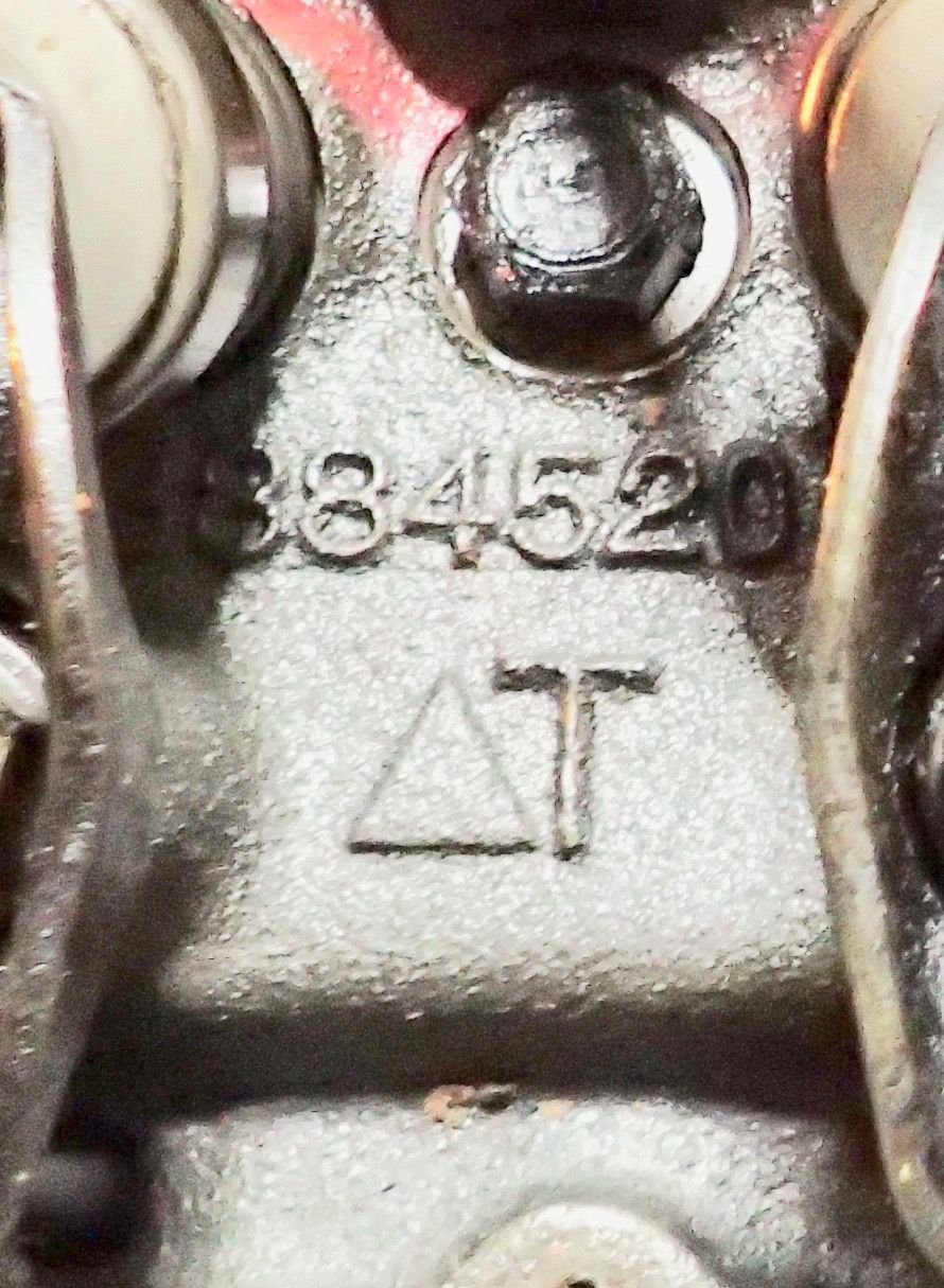

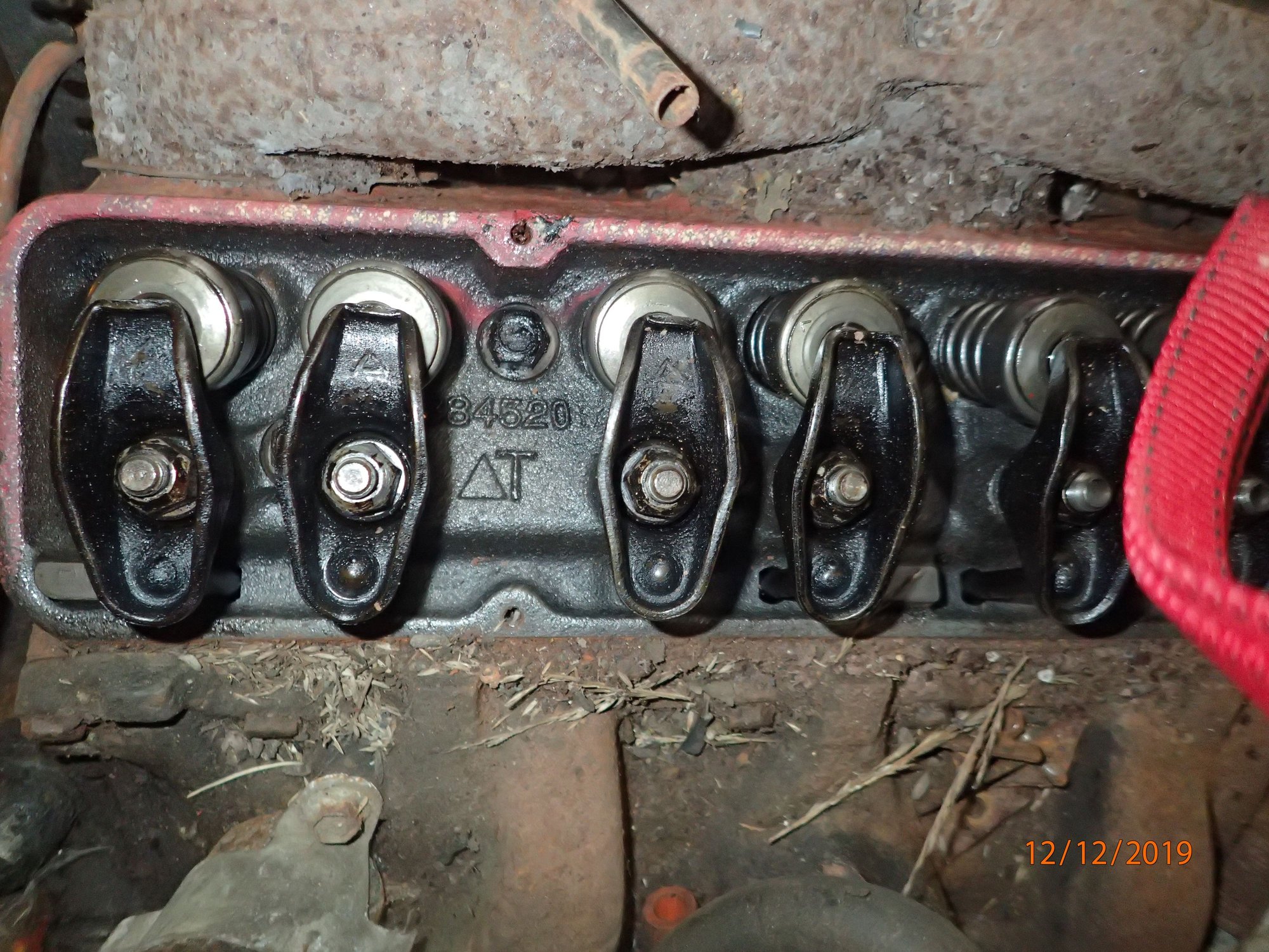

I have a 66 truck engine in the shed, not completely sure what it is, 283 or 327, just had the heads done before the truck went to crap so stripped the engine and trans and they just been setting for about 20 years. I think they are single hump heads. what numbers are on the heads you have.

Old Dec 12, 2019 | 01:15 PM
Posts: 22,042
these are 3884520
Old Dec 12, 2019 | 02:19 PM
Posts: 22,042
valves are same ill have to go back and get a pic of front for you to check to see if bolt holes are same as yours. back has no holes
