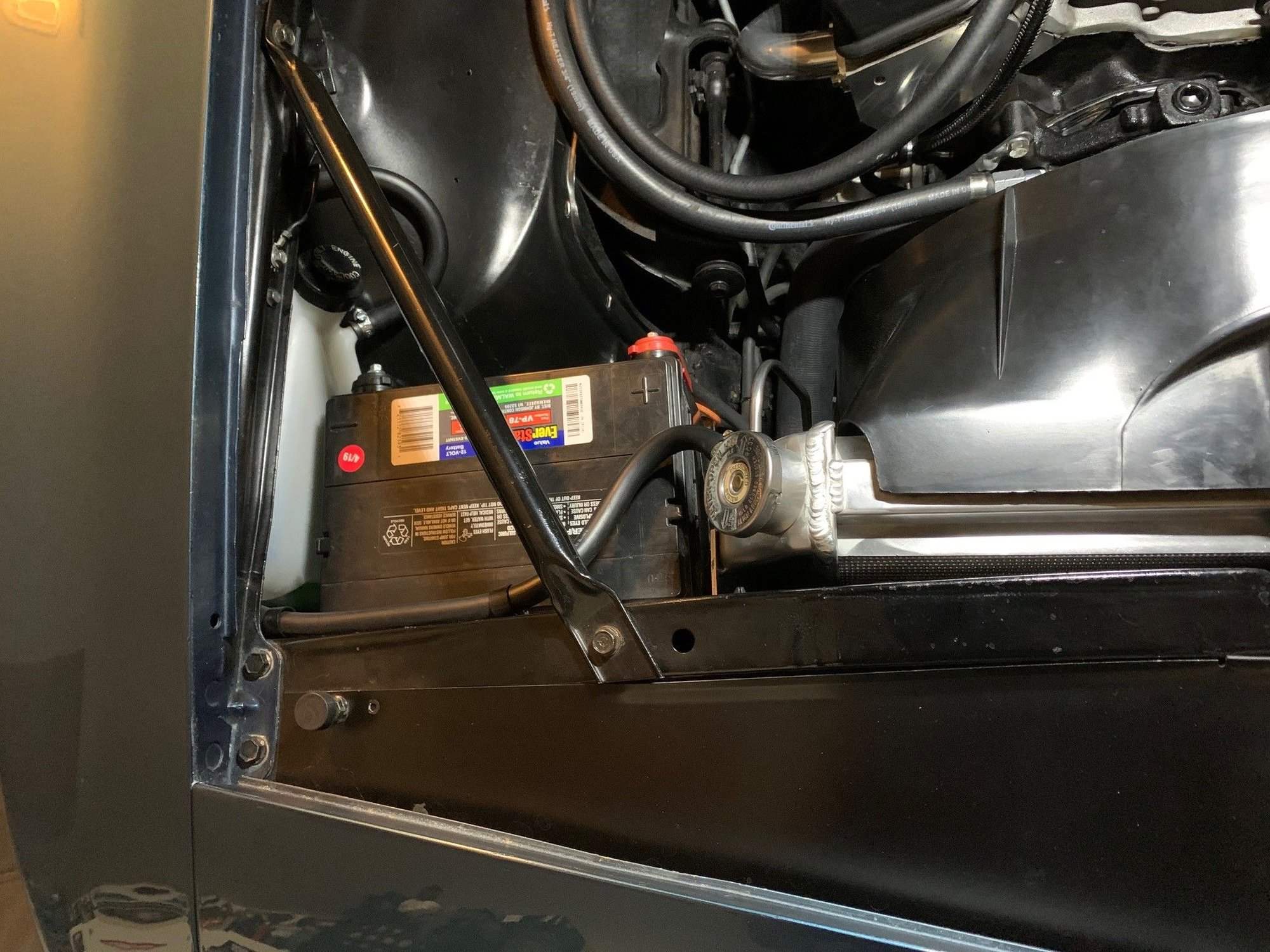

75 Nova tank. Fits in PS fender. Just drill one hole in fender lip
Its a "coolant recovery" tank (read different from overflow). Like modern cooling system you fill radiator to top and put a few inches of coolant in tank. Engine/coolant heats up (exspands) and will go into tank. When engine cools it draws coolant back into radiator. You need a "closed system" cap. The tank does not come with a cap so have to buy that seperate. I got mine from Summit for around $40
