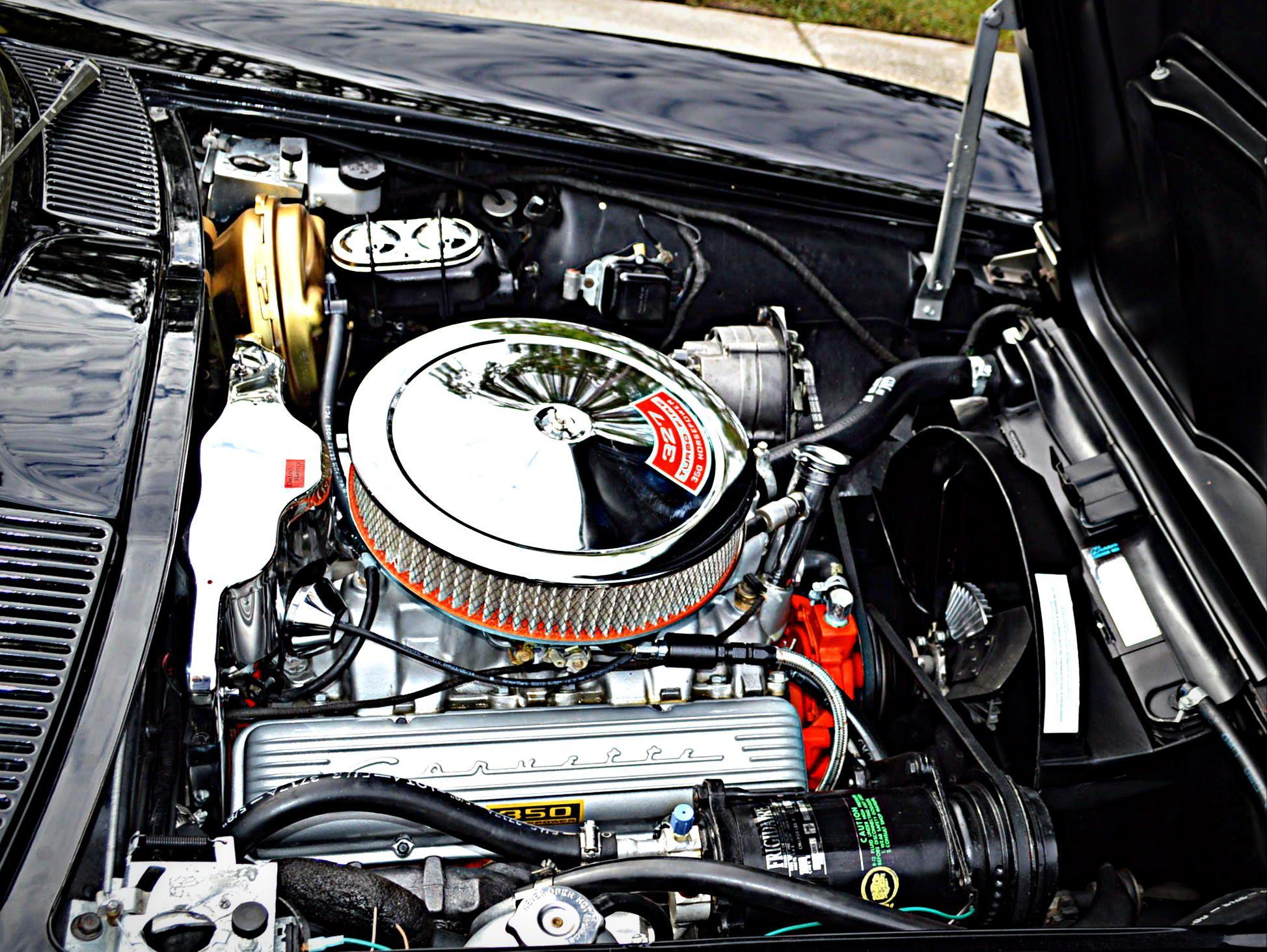

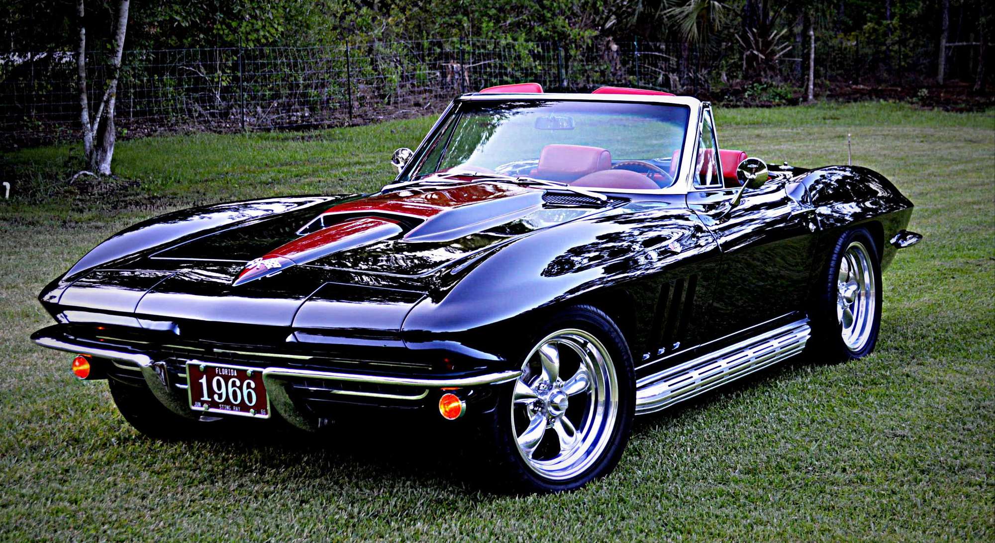

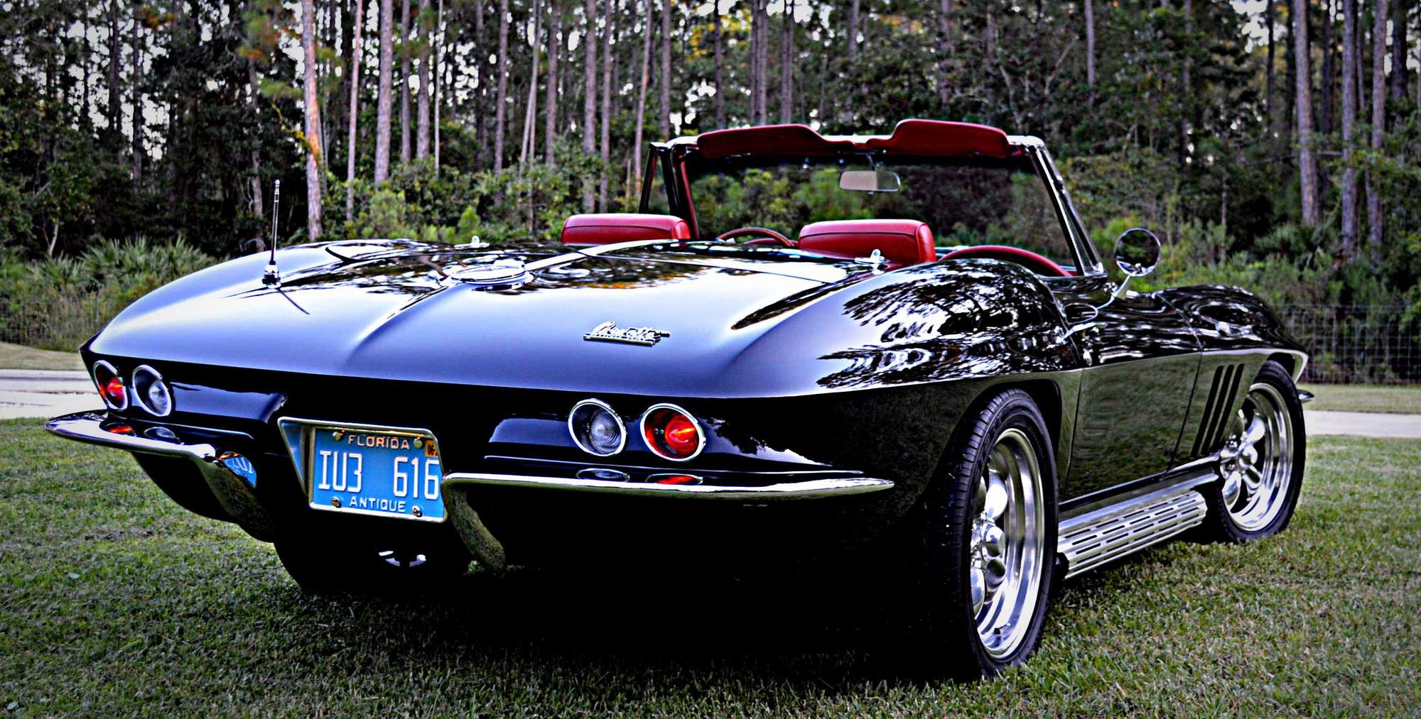

Please go easy on me first post at this sight. I am a "car guy" and a Chevy guy, very informed on C2 63-67 (pic of my 66 attached) and early C3 Corvettes. But not so much early Camaros, always liked them. I looking at buying a 67-69 Camaro. This one caught my eye as I am leaning towards a vert and that really limits what is out there. I know the original 307 is a mild motor at best, but that is not a big deal for me. This is more of a top down cruiser for me. I like the 4 speed Muncie manual conversion. Should I be Leary of the "all new metal" does that mean a bunch of after-market panels? If so, what is the typical fit, finish, and quality of them? What are your HONEST thoughts on this car. Not going to offend me, I am not set on it at all, just wanted opinions from people far more knowledgeable than me on these early Camaros. https://www.ebay.com/itm/175215967407

Welcome to CF,love the Vette that's a stunner!
