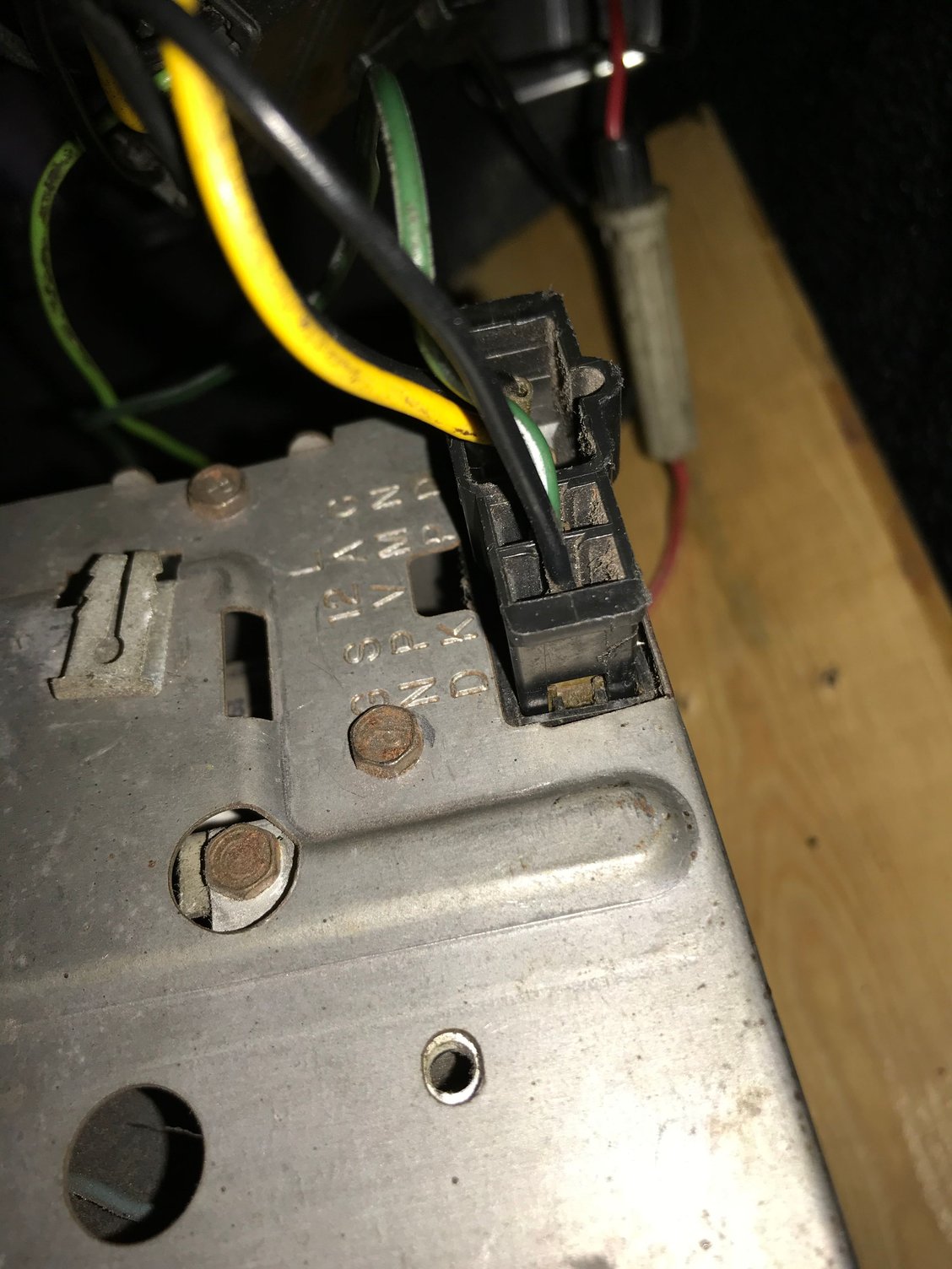

Hi, Guys. Made some progress but can't quite get my AM radio to work after unplugging the 8 track. Seems that I do OK until I get to the 3 prong connector coming from the 8 track. Once disconnected, the radio loses power. Can't seem to figure out how to get power back to the radio without reconnecting this plug back into the 8 track. No place to hook it into the radio as the radio has only one plug into it.
If anyone is still following this thread, I'd appreciate your help!!! Some pics attached. Thanks

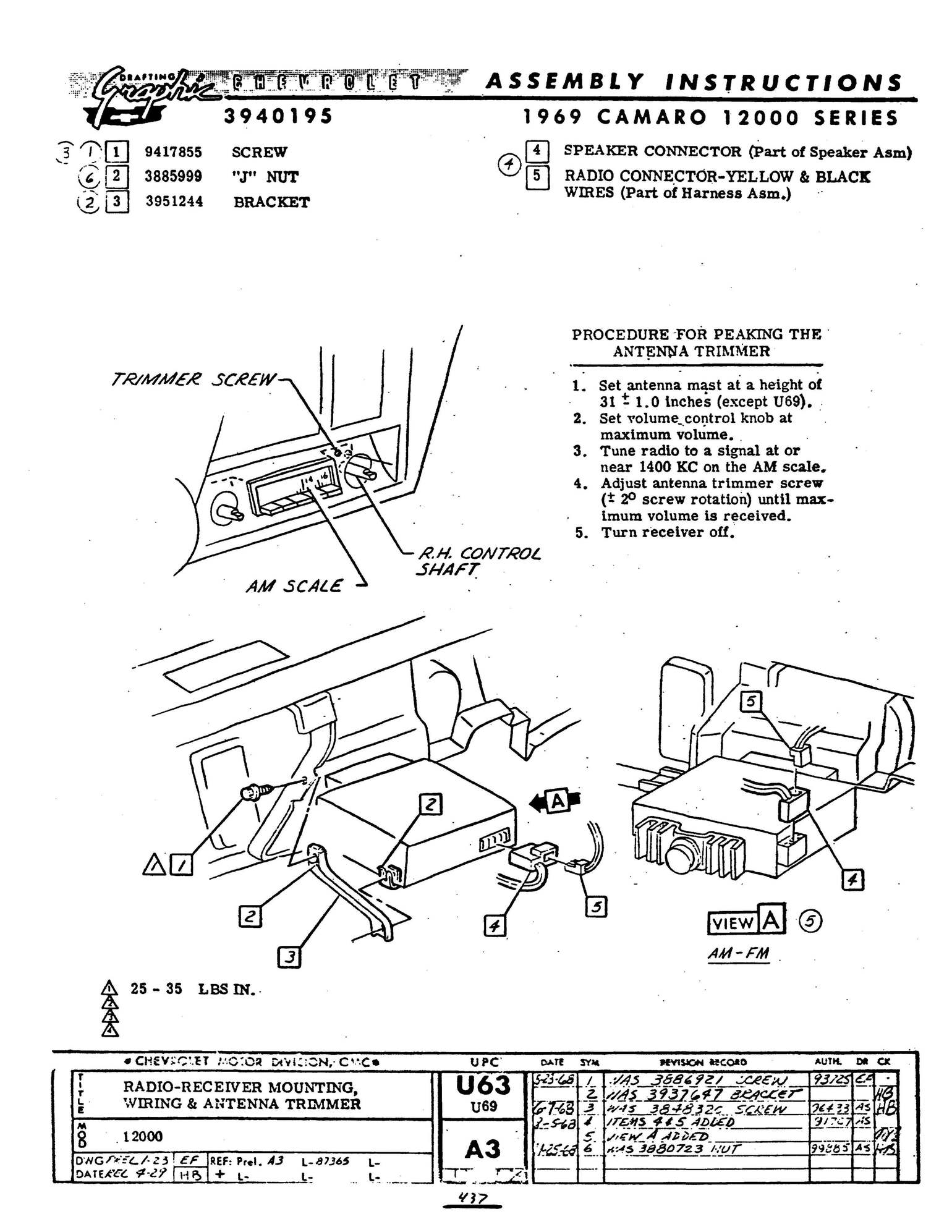

The 1969 Assembly Manual has some information on the console tape deck, but it doesn't get into detail about the power supply and I couldn't find a schematic that shows the radio. Hopefully, maybe these drawings will help.

Thx to all! By design, the radio got its power FROM the 8 track so that the radio would turn itself off when a tape was inserted. There was a connector between the two to facilitate the power.
By jumping two wires on the radio’s end of the connector, the power was able to re-route itself and make a u-turn back to the radio!
