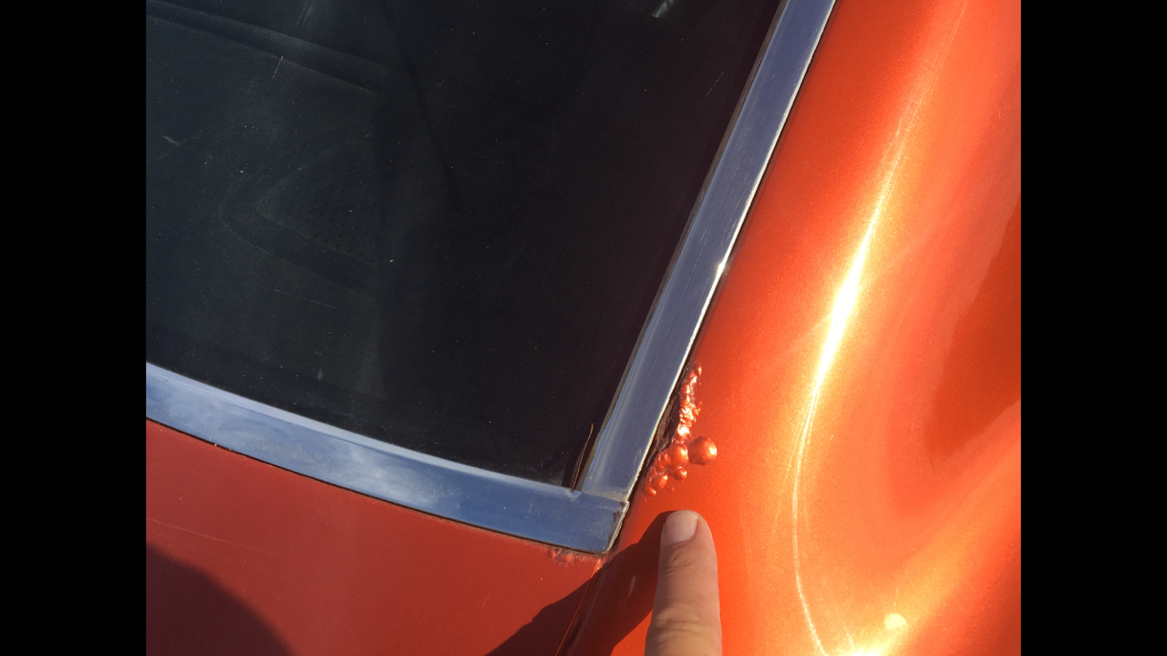

Hi Guys,
Looking at buying a 68 camaro but it has a lil rust on the rear window the bloke selling it says that hes checked the whole car over and can only find that and he doesnt really know the history of the car all he knows is its been garaged since 2010. is this a common problem cheers guys68 camaro-camaro.png

Yes, common problem.
Lift up trunk floor mat and if water leaked in, very common, floor will show it.
Nice color - good luck.

Yep, this is a very common place for rust in these first gen Camaros. Get into the trunk and look up at the package trey to show some rust.
