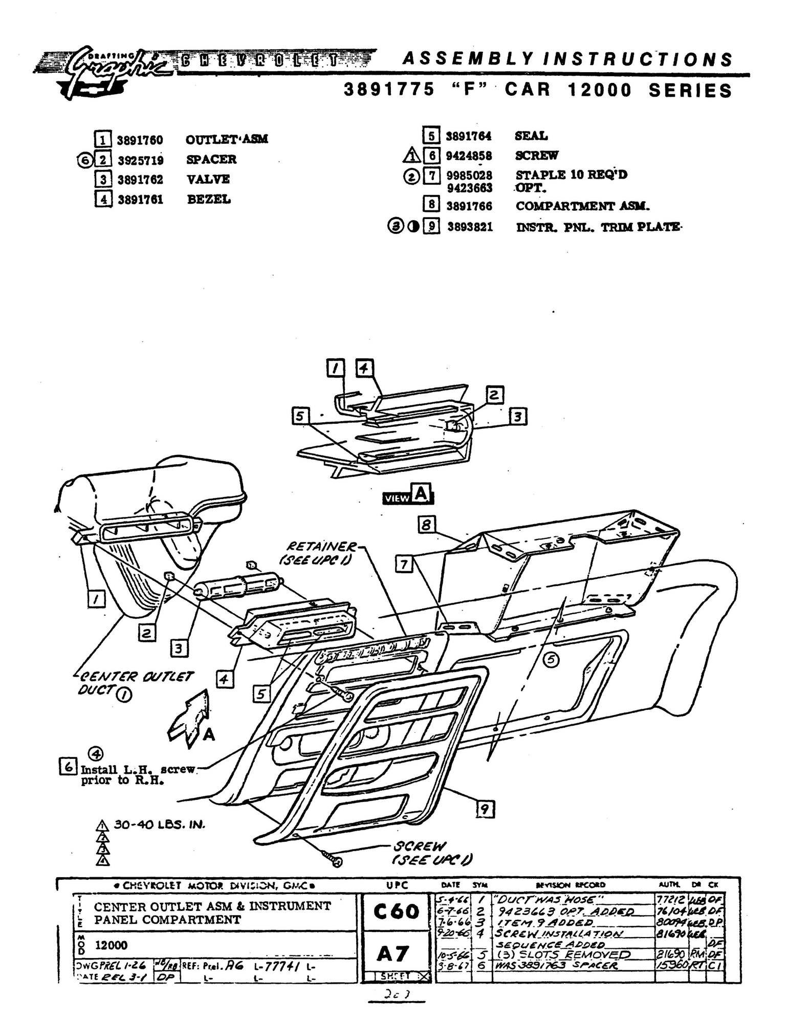

Does anyone have a picture (or a part number) of the piece/duct that fits behind the center dash air vent? Basically trying to figure out what holds the rotating vent itself in place. I can't find that section in the assembly manual.

Hope the below helps.. The first link should be the item your looking for on Camaro Central website. Check the others out too
https://www.camarocentral.com/1967_1...t_p/duc-75.htm
https://www.yearone.com/Catalog/1967...s-.-components
https://www.yearone.com/Catalog/1967...ter-dash-ducts

For future reference, it is shown in the assembly manual back in the option index portion listed under C60.

Thanks guys, those are exactly what I was looking for. And I eventually found that page once I saw the UPC C60 on yours.
