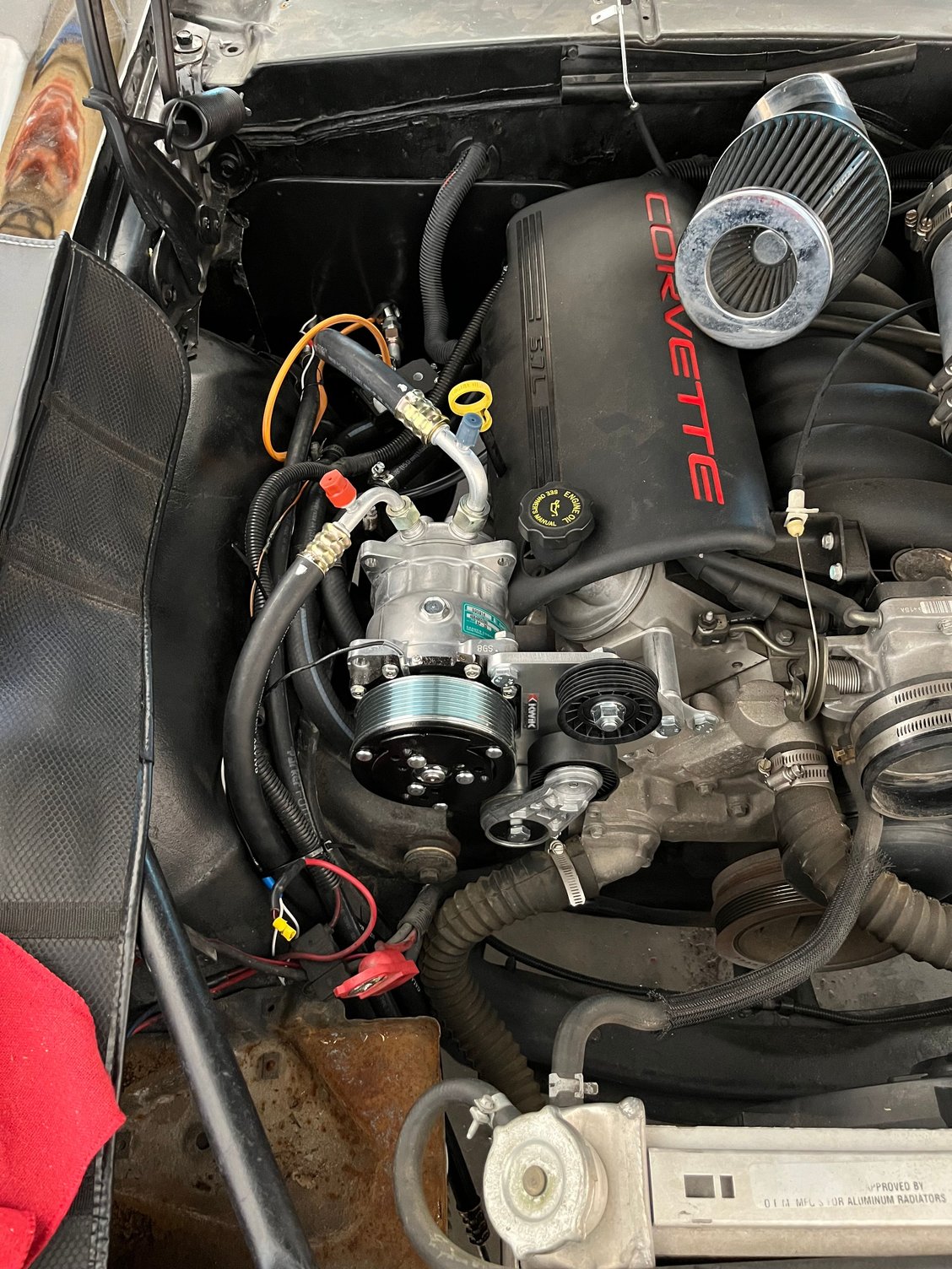

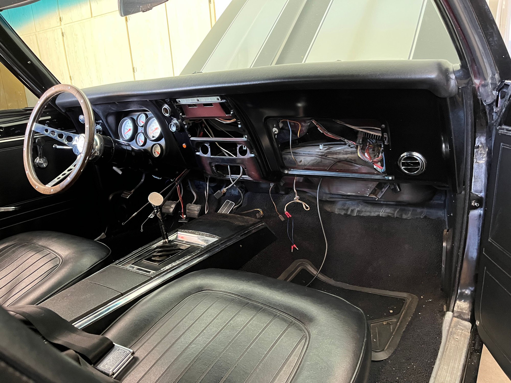

I put Classic Auto Air in my 67 RS that didn't come with A/C about 6 months ago and it was pretty easy. The kit was about $2,400 and when I called around to some places that had done others, I got quotes anywhere from $12K to $17K. Go for it there are some pretty good sites on the internet that helped with showing some of the things I didn't quite understand. Oh, and I paid a guy about $200 to charge the system after I put it all in. Trickiest part was drilling holes in the dash to put the side vents in. Good luck!

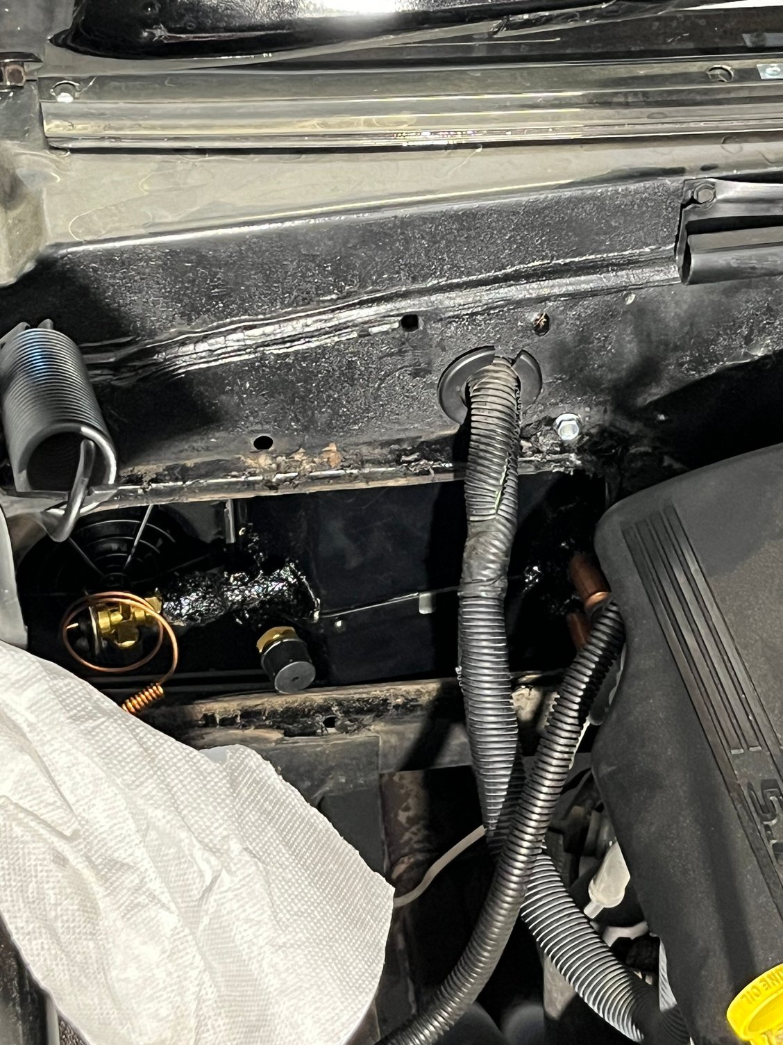

I did not remove the fender. If you zoom in to the upper left you can see I used a Sawzall to cut the heater cover as close as I could to the inner fender. I took my time over probably 4 weekends working maybe a total of 10-12 hours. If I didn't screw around listening to tunes, mowing the lawn, doing honey do's, and doing other stuff at the same time, I could have probably narrowed it down to 3-4 hours. I have some other pictures of various steps and some internet links if you need anything. Good luck with it. Rob
