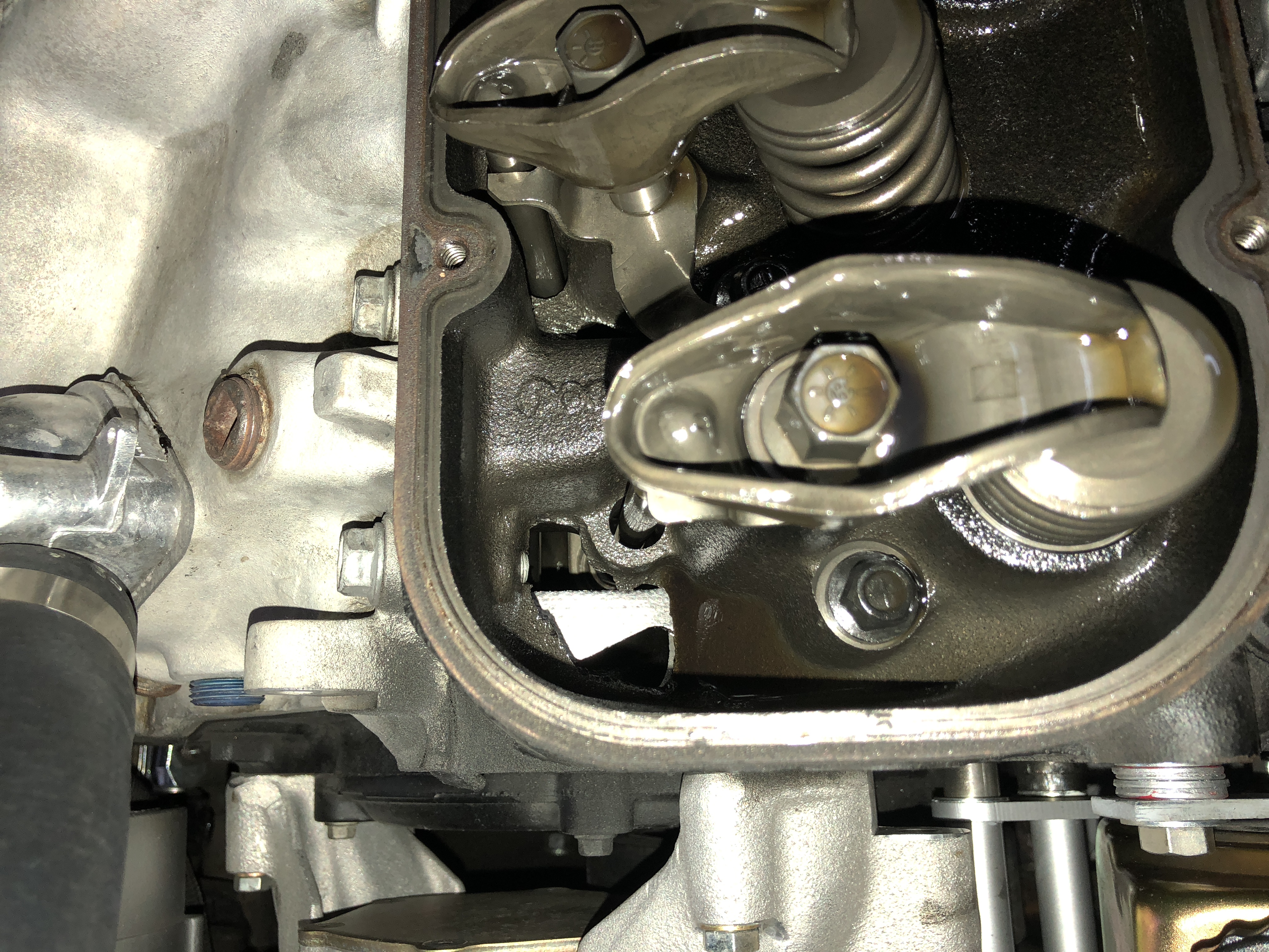

So I popped off the stock valve covers off my GenVI 502 to grind the paint off the tops and was a bit shocked at the oil galleys on the stock heads. I don't have any experience with BBC dismantling so I'm not sure what the original size was or if this was the way they were made...any comments on the size of that opening on the top left corner of the head?

Those 'holes' are drain holes from oil being pumped through pushrod to rocker ball and stud and rocker tip onto valve stem.
Oil pumped up has to drain back for cooling and lubing purposes.
Size of hole determined by casting head was made/poured in at foundry.

Yeah it just didn't seem right that the material is so jagged and thin around the circumference of the hole. Almost seems as though it got punched out. Thanks for the note.

There not punched out , it's part of the castings of the head !!
