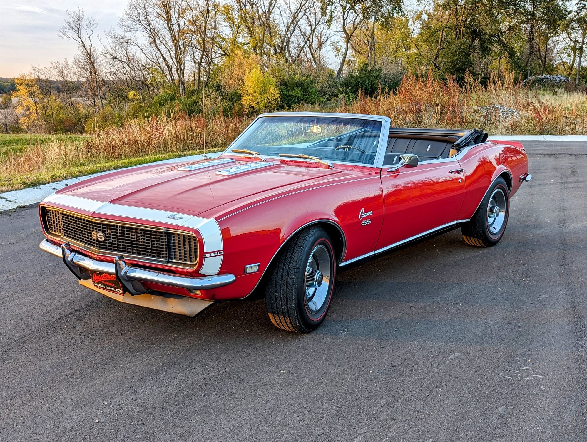

I've got a couple leaky calipers in my '68 RS/SS Convert, and I'm looking for any thoughts on replacements. NAPA has both Proformer and Adaptive One remans for around $200 per side, and O'Reilly has a reman option for a little less. My rotors are in good shape, so I wouldn't have to replace them, but I've been considering the Wilwood bolt-on OEM replacement kit https://www.wilwood.com/BrakeKits/Br...+Brake+Spindle, wondering if it is a better quality and/or performing caliper, and for not much more money, it includes rotors and pads.
The car is a cruiser and will not see a ton of miles in the foreseeable future. I'm not looking for a serious performance upgrade and I definitely don't have an unlimited budget or a desire to make major mods. I'm looking something that will do the job well, and not start leaking in the next 10+ years with limited use. Any input is appreciated!
EDIT: I also found reproduction calipers with stainless sleeves from Classic Industries for about the same money as the remans. Would this possibly be my best, cost-effective solution? Any experience with those units or the Wilwood ones would be helpful info.
