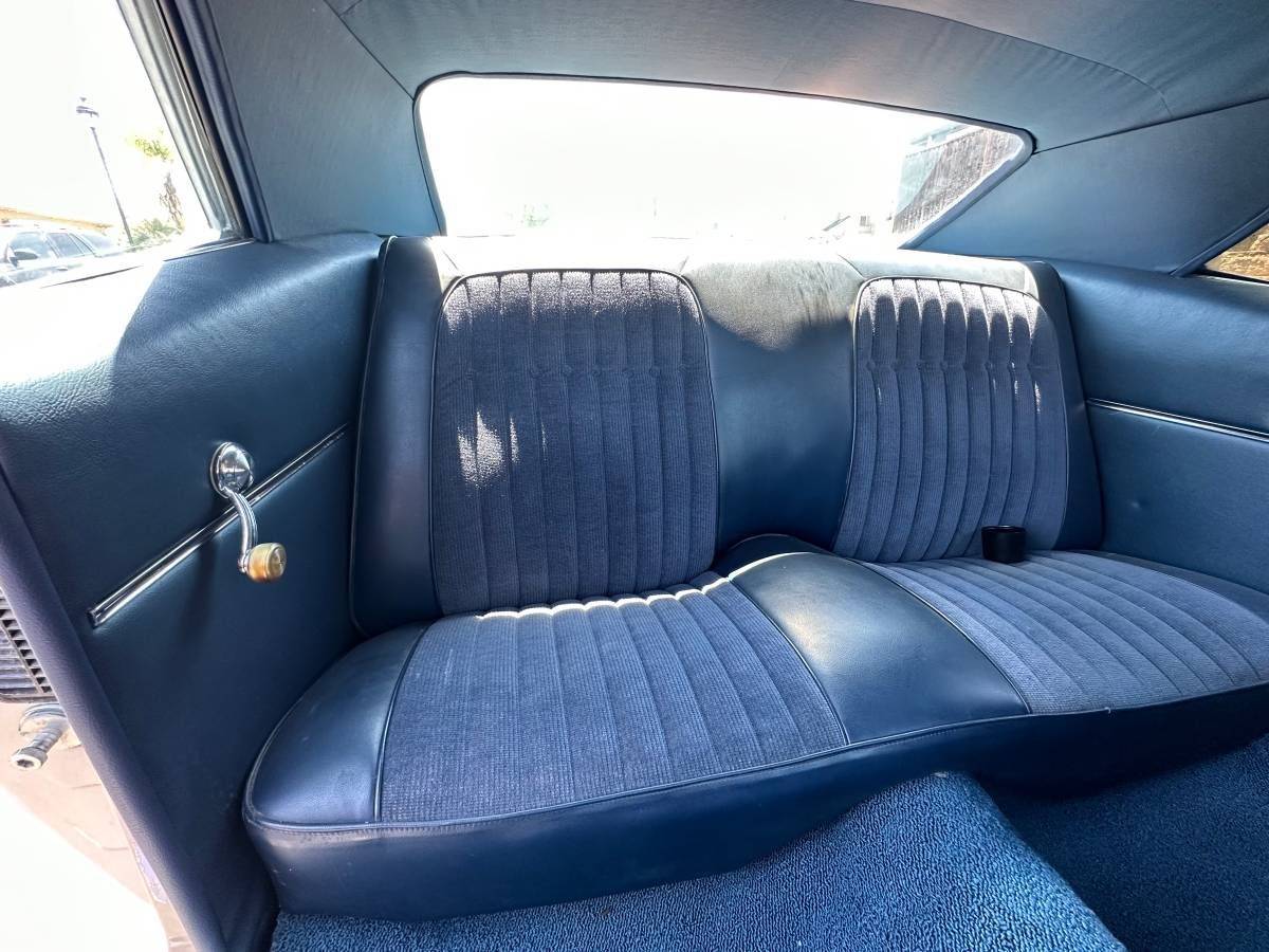

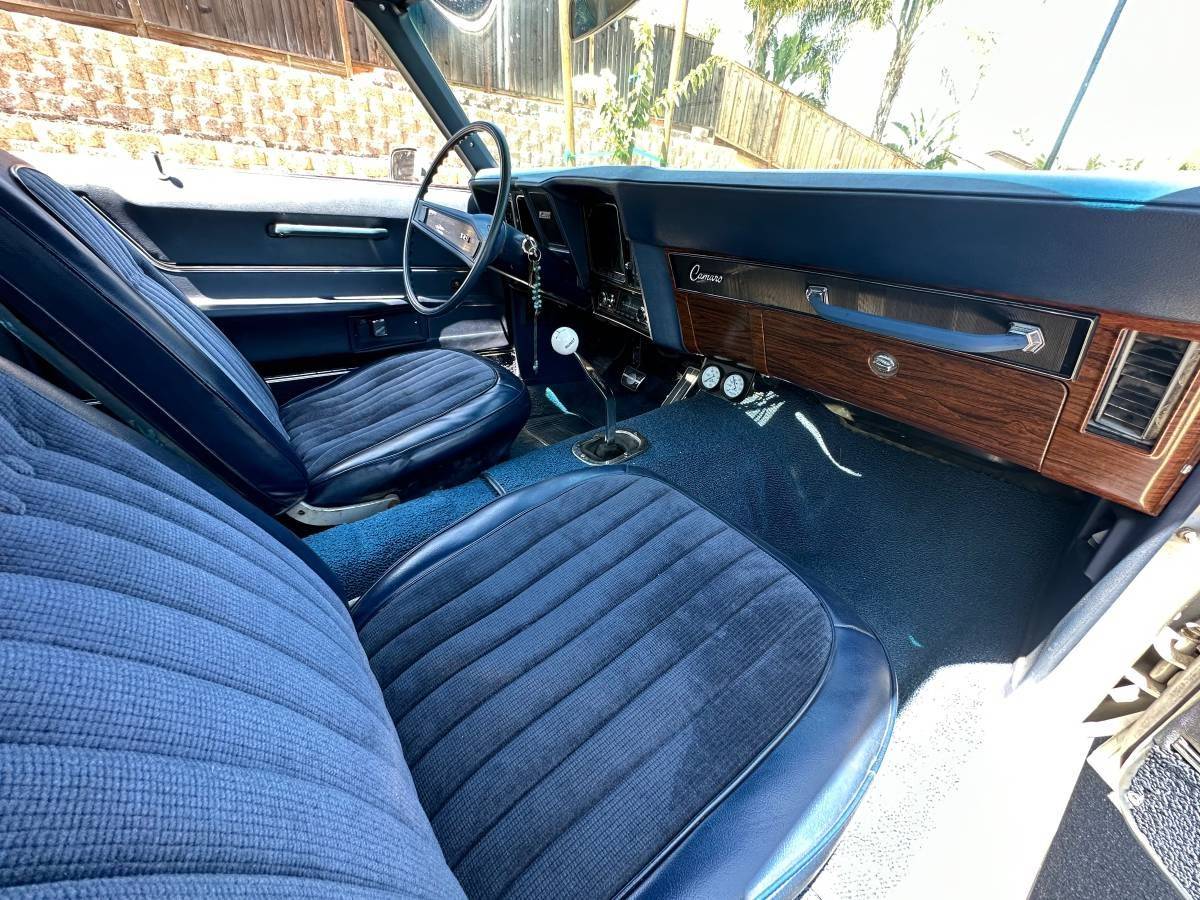

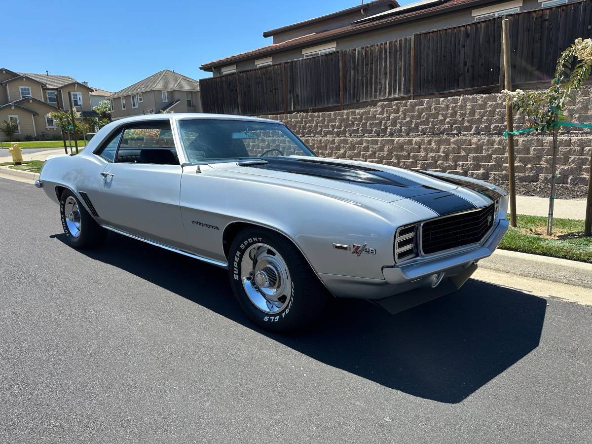

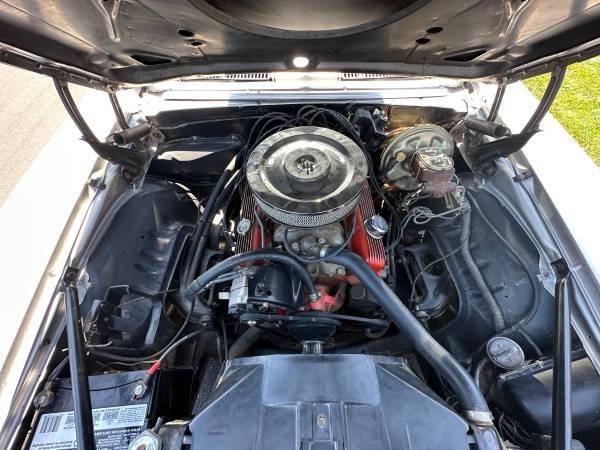

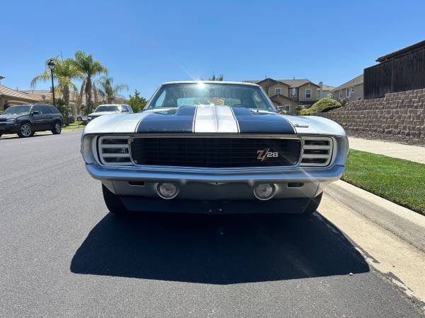

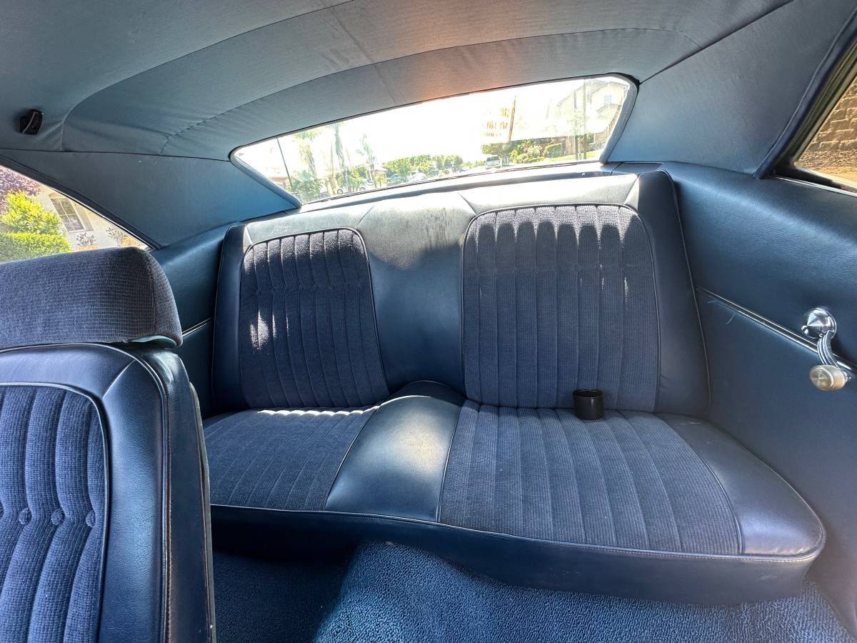

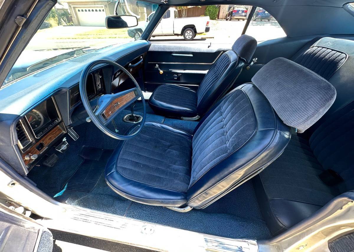

I am looking at a 1969 Camaro Z28 to buy, seller says numbers matching, original 75K, asking 80K$, what do you guys think? See pictures. Says Arizona and CA car. Thanks.

What is the stamp #'s on engine pad (PS front of head)?
Not going to comment on interior....
FWIW Z28 is the most cloned 1st gen so at $80k do your homework. #'s off rear end, trans, hidden VIN under cowl. All need to be confirmed.

What others said,the only way to be 100% sure is buying from the original owner or family with supporting documents and given the age those are very few and far between.
Great looking car but the interior is a red flag for me,any combination could be ordered but I've never seen a Z28 without a console that's housing gauges.
There's a few things in the engine bay that do not look correct for a low miles numbers matching car as well.

I owned a 69 Z-28 until a few years ago
There is enough wrong with this one for me to simply say it is a clone
The valve covers and air filter cover
The DZ motor numbers have not been shown
The interior is wrong
Those cars are worth enough that no one would install non factory parts on one

2 things that only came on a 69 Z/28 were 4 leaf rear springs and an 8 grand tac. And all 1969 Z,s had them.
I take that back maybe a copo car could have had an 8 grand tac.

I beg to differ on that tach but agree on the springs
I have witnessed 69 Z-28s with a console and no 8 grand tach
I had a matching number 69 Z=28 with no tach at all and no console (best deal I ever made selling that car)

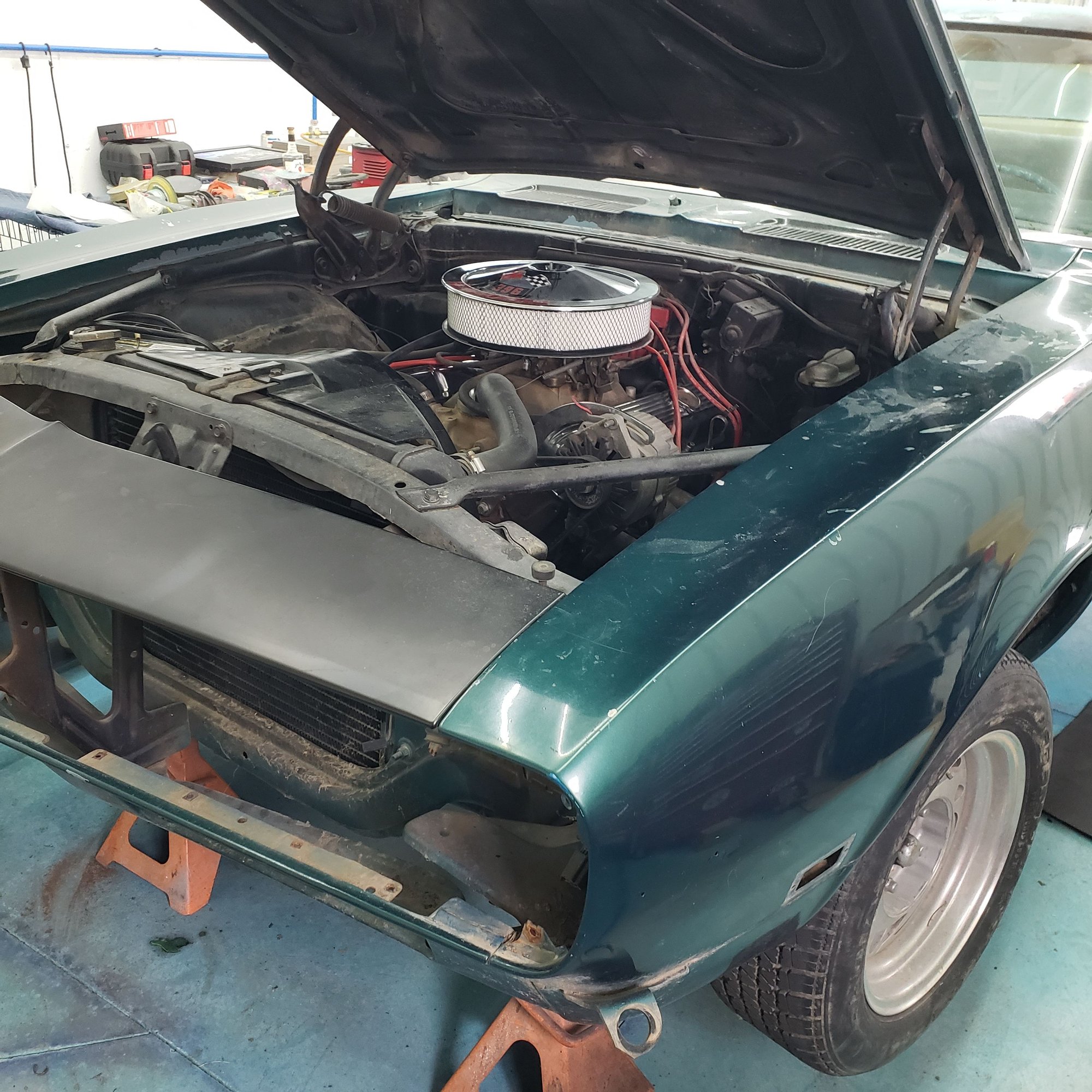

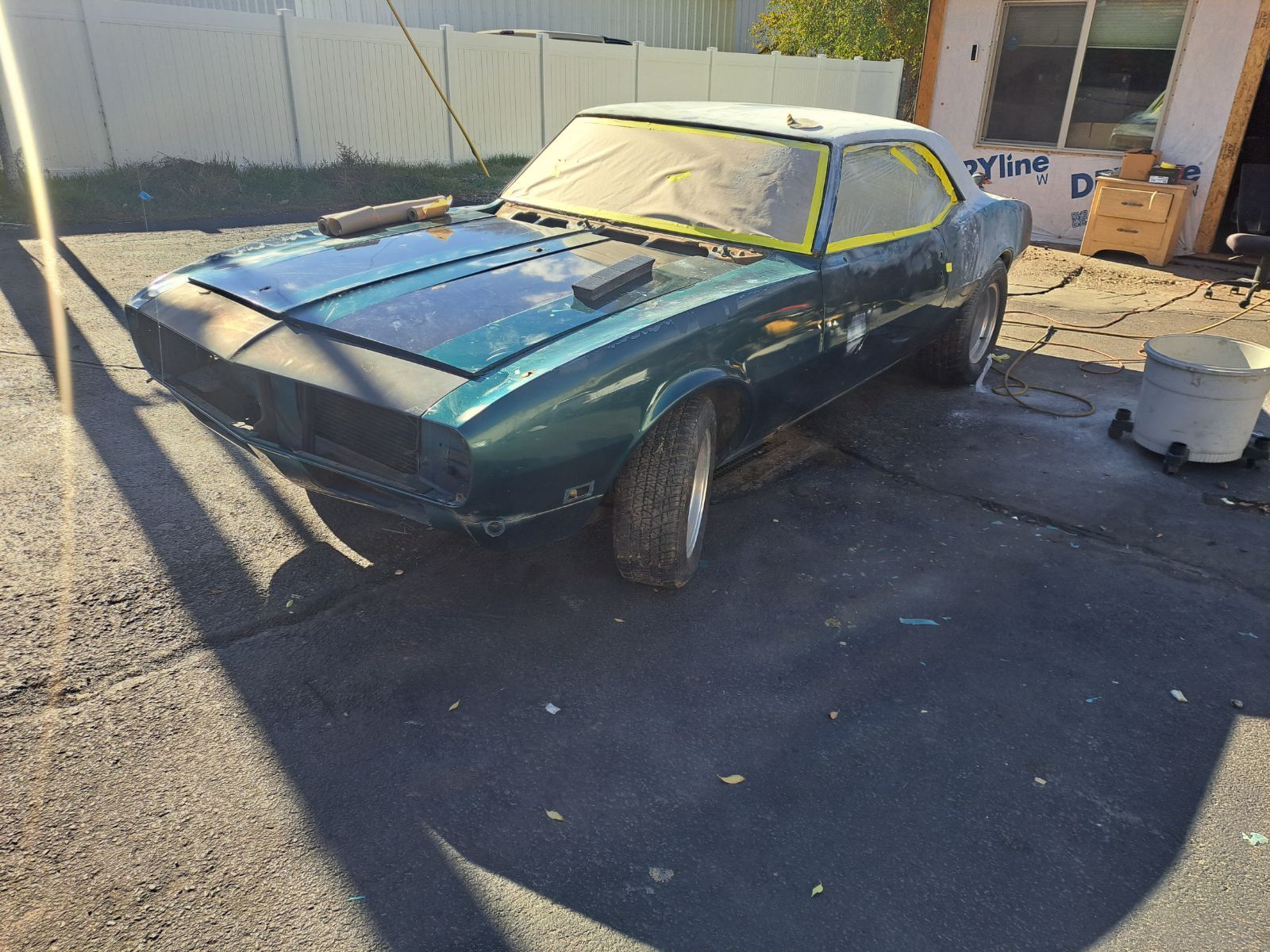

Here is my plain jane 68 coming along at the body
shop
