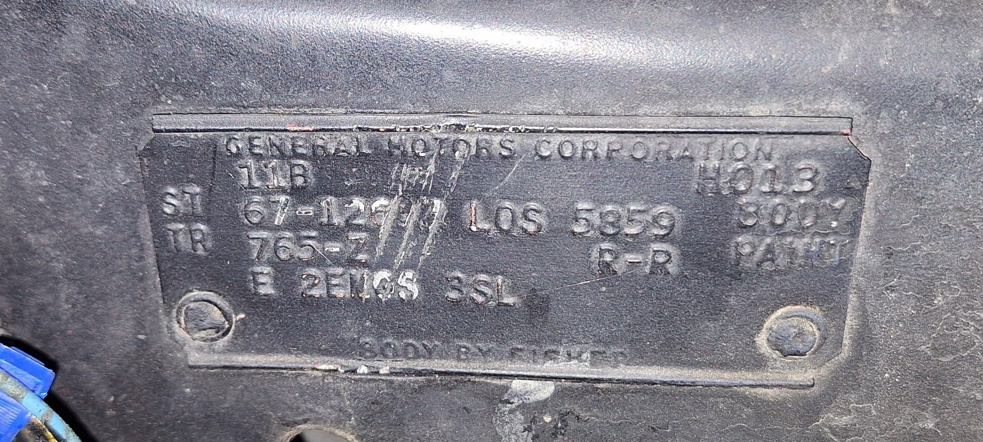

Thanks for this link and info. Perhaps you might help me with my decode - It says 765-Z then E 2EMGS 3SL
I gave it a go but got stumped.
Old Apr 2, 2024 | 11:48 AM
  #18
Posts: 10,560
67? Take a picture the Cowl tag, Where the numbers are on the tag helps.
(3SL) S= Z23 interior L=RS
(2EMGS) E=AC M=Automatic G=Console S= antenna
765-Z =Buckets E= black.
You need a 4X for an SS.

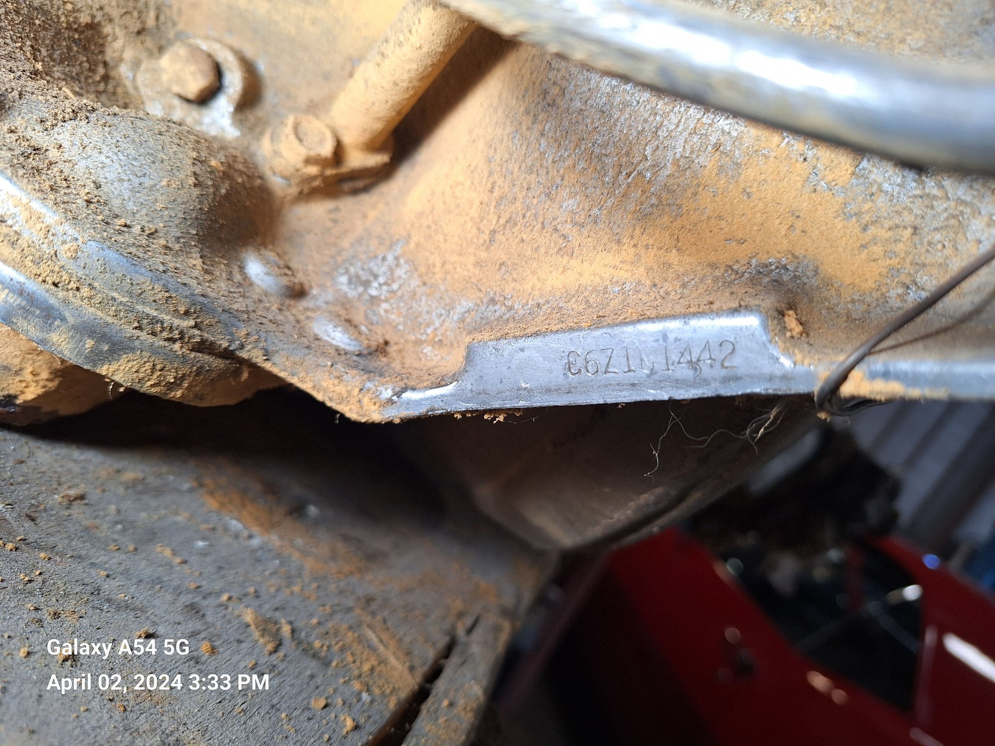

Default transmission side stamping
Thanks so much. I should have dug a little deeper. Nice that it's an RS. A transmission did
come with it. Here is the stamped number - C6Z161442. Can you learn anything from this? I have owned it for 22 years or so.
