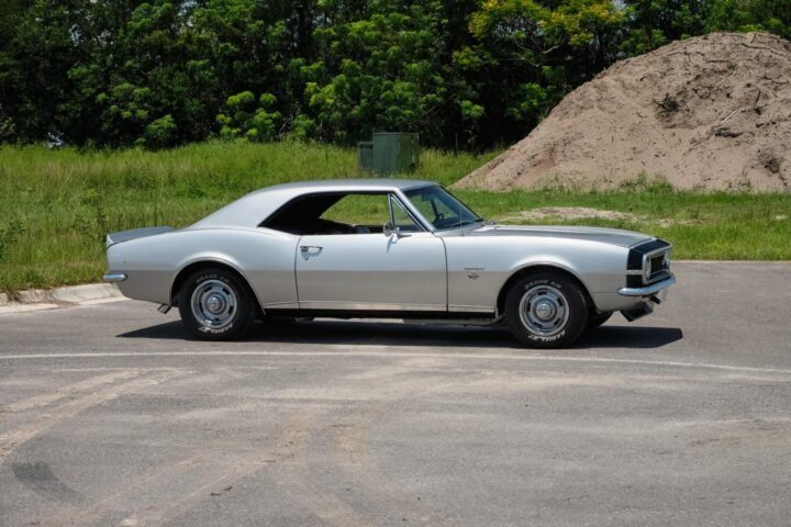

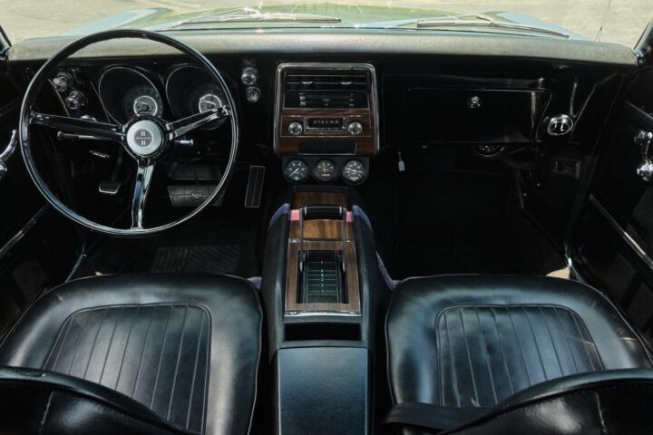

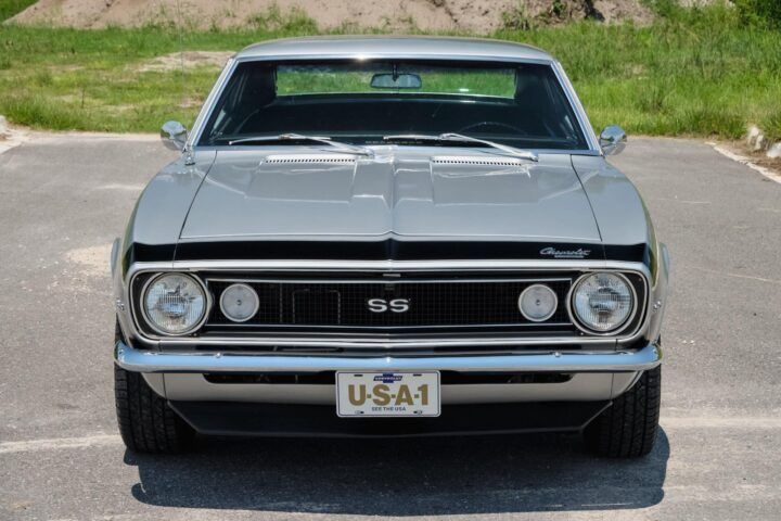

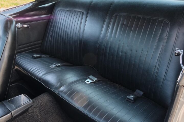

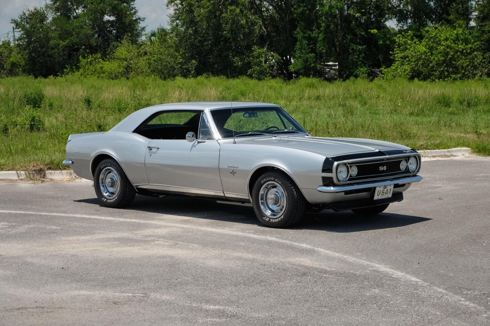

The link worked,here's a set of pics.
Car looks pretty nice but is obviously not a real SS.
Only two motors were available in an SS Camaro in 1967 the 350 and the 396 so even the 327 badge on the fender is wrong.
The 1967 350 is a rare motor these days,it was the first year for the 350 and it was only available that year in the Camaro and only in the SS Camaro.
Looks like new seat covers not done really well but other than that everything looks nice at least from what you can tell looking at pictures.
Maybe you can find out who did the resto work on it and check their reputation out.

pics do look nice. It looks to have a TH350 trans and 69 shifter. Not sure what rear end it is. It came with the 10 bolt mono leaf rear springs. It's an AC car or the dash was swapped to a AC dash. Someone spent sone $ on it. If the body is not all bondo under the paint, it would get about $40k here in CA
