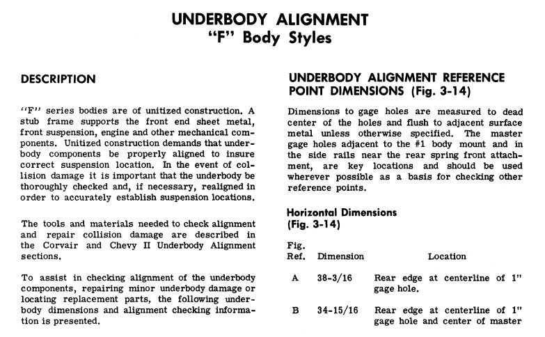

Youtube video may help.
1.562" diameter holes
Pictures from 1967 Fisher Body Manual.
Attached Thumbnails `67 Camaro - Body mount holes template-ub1.jpg   `67 Camaro - Body mount holes template-ub2.jpg   `67 Camaro - Body mount holes template-ub3.jpg   `67 Camaro - Body mount holes template-ub4.jpg

Thank you for answer but the i`ve seen this drawings. Still this shows dimensions of the gage holes, not the Mount holes ( Or am i missing something ? )
About the video - the guy takes measurements from the other side that is good.
Thanks
