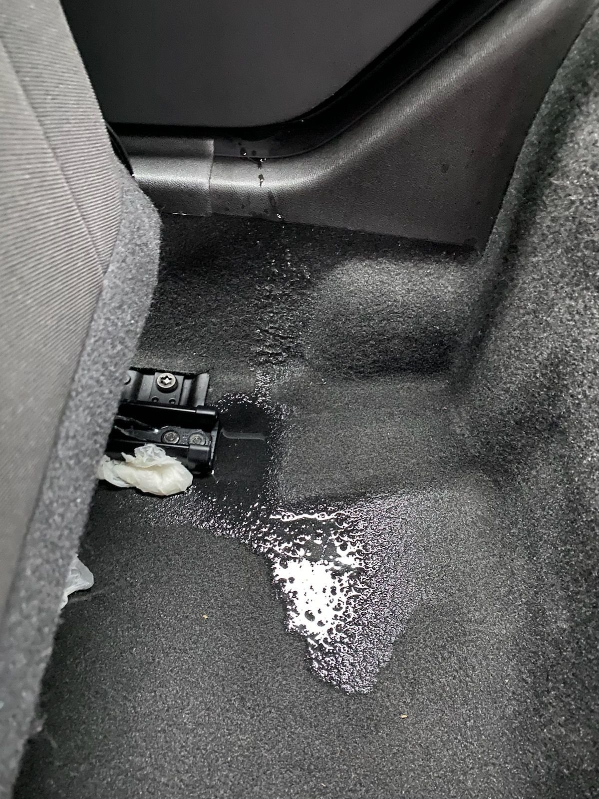

Hi everyone. I am new to the forums and hoping that someone may have some thoughts on my situation since you all are familiar with Camaros. I have a 2023 Chevy Camaro with 600 miles on it that I purchased back in July. It is not a convertible, but it does have sunroof. About a month after I purchased it, I noticed that whenever it rains the water is entering the car and pools on the rear passenger floor right where the metal seat track is. I do not think this is sunroof related as the water is not even close to it. It is the same scenario every time it rains. I brought it to the dealer I purchased it from twice and first they said I left the window open and then they said they did all their leak tests and air pressure tests and found nothing. I sat in the car while someone sprayed the garden hose and took a video of the water pouring into the car. I sent everything to GM and opened several cases. I went to a different dealer this past February and their experts "adjusted" the door and said it was good to go. A few weeks ago, after it rained, I checked inside the car and there was even more water in that same location, so much so now all the wiring for the seats is getting wet. I have an appointment next week yet again and another case has been opened with GM. When I open and shut the passenger door it does not feel the same as when I open and close the driver door. I am not sure how to describe it, but it seems lighter or something, not sure just seems like there is something off about it. If anyone has any thoughts or suggestions, I would greatly appreciate the help.

Hi! After being in contact with GM corporate at least once a week and speaking with a representative in the lemon law office, I sent Chevy/GM a certified letter about my Camaro and lemon law. I then brought my car into the dealership one last time. Finally, I got the mechanic that would actually listen (plus all my other written and verbal correspondence) and my Camaro has not leaked since (knock on wood) this past April. We have had some heavy, heavy rainstorms and I even ran the garden hose full pressure and perfectly dry inside. The mechanic ended up having to remove the headliner and found that the sunroof drain hose was attached but loose on trough, just enough for the water to escape. He reinstalled the hose and headliner. I had my car back in 2 days.
