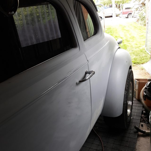

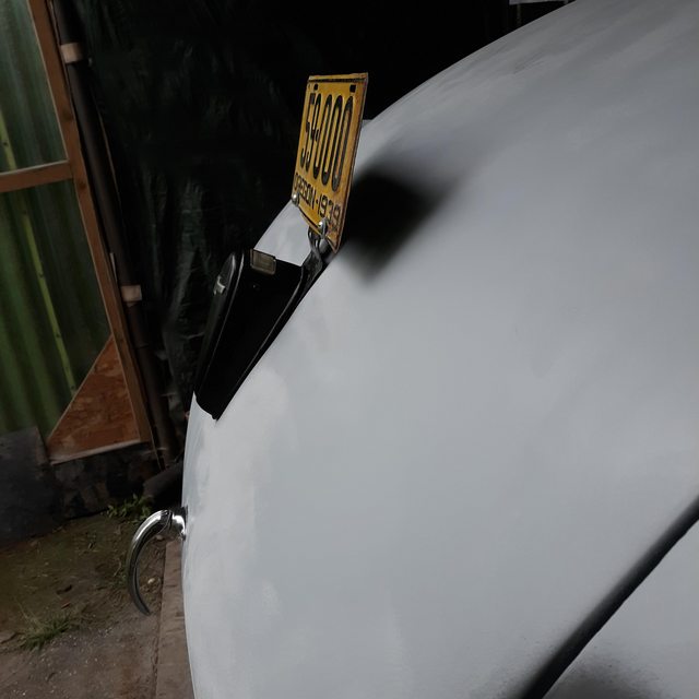

Located an original license plate light and rebuilt the socket for the lamp. Made a plate bracket and mounted it up to check fit.
Dug out all my new glass and after finishing the channels and weatherstrip, I have all the side glass installed now.

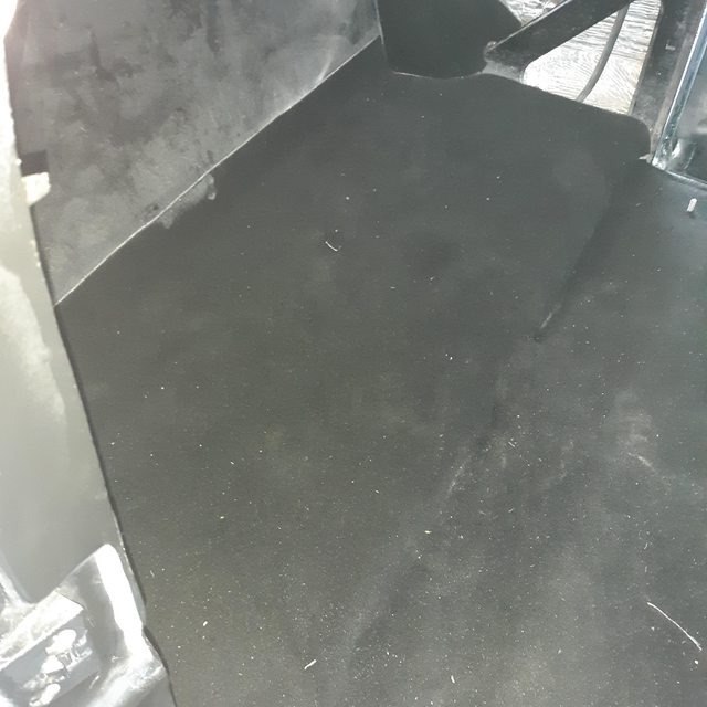

Also dug out some new black carpet I had stored here for my '63 Falcon that never got installed. Just the perfect amount to do the '39 floors, and not more than a foot of scrap leftover! Too close, but made it.

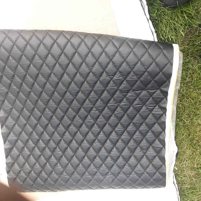

I purchased pre sewn black vinyl in a 2"x 3" diamond pattern to do door and side panels old school style. Once the headliner is in I'll begin covering all the panels I have cut out and get them installed also.

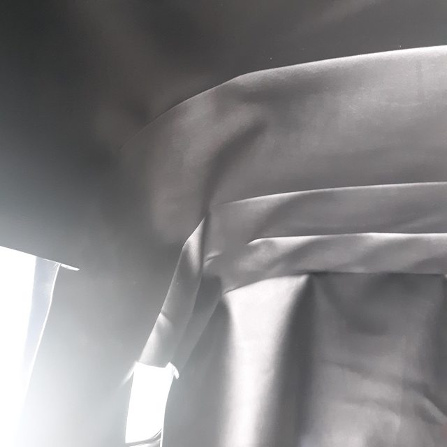

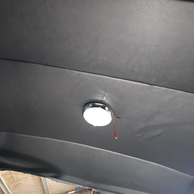

Sanded and fought all my bows into the loops on the new headliner. Man those are a battle to get the curved ends fed through the loops, and even worse after the first one! Got it marked up for center, and hung it from all 5 bows. The first two are just wire bows, but the last three are stamped out and screw in place at each end.
Plenty of extra material, so sure no issues worrying about whether it might be close in places! Once I got it hung I began pulling it forward, and then used 3M spray adhesive to attach it around the windshield opening, and clipped it with small clips to hold it while I worked it back to the rear window. Then glued and clipped it back there also. Worked it side to side with more glue and clips until it was smooth. The 3M glue is nice because you can pull it back off if you do so immediately, so working ripples out is easier.
Still need to steam it, but it's pretty smooth, and just some folds from shipping that need to relax a bit.

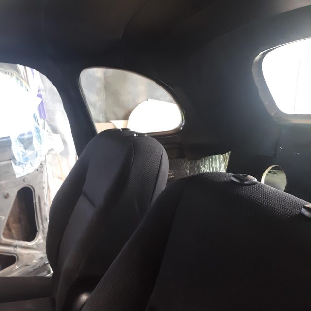

Got the interior cut to shape, and covered the kick panels in smooth black vinyl. The rest will get the diamond pattern. Reinstalled my shifter and boot, and the bucket seats too.

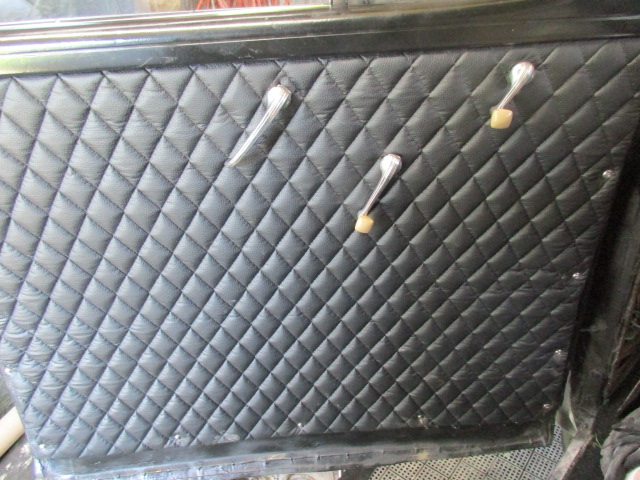

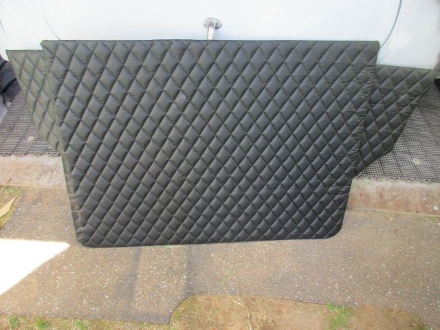

I got my interior panels covered the other day, and today I installed the old school diamond tuck panels on doors and 1/4 panels.
The door handles were decent, but ***** were corroded and stuck, so frozen to the handles. I found kits to rebuild the window cranks and vent cranks, so cut them off and installed all new *****.
