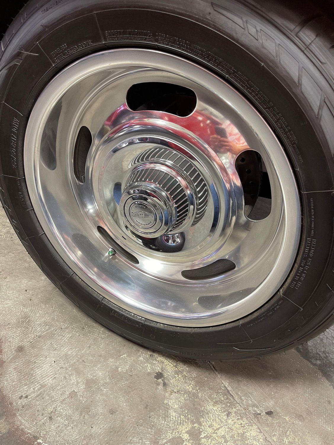

Only other pic of I have is of the rear tire and wheel. I was talking to someone locally who was trying to help with the rub.

Simply giving it normal gas causes the rears to rub but looks good! I contacted CPP how I can get 15" wheels on it and was told if 13" or 12" rotors they won't fit. I have to have 11" rotors. However, I have no idea how easy a swap this is or what the story is with their calipers fitting.

The car you hear about that have a lot off issues right after the auction are built solely for the auction and how it looks on a stage is the most important thing. I have seen brand new spring heated to get a certain stance. They effectively ruined the springs by removing the temper out of the steel and make them prone to cracking. They also load the car up with all the "right" parts but never look at tweaking them to get them to work together as they should. That does not mean you should toss the parts. Tires rubbing in the back could be as simple as a small spacer to push the wheel out or a shackle replacement. A serious brake issue can sometimes be fixed by adding the correct or an adjustable proportioning valve.
