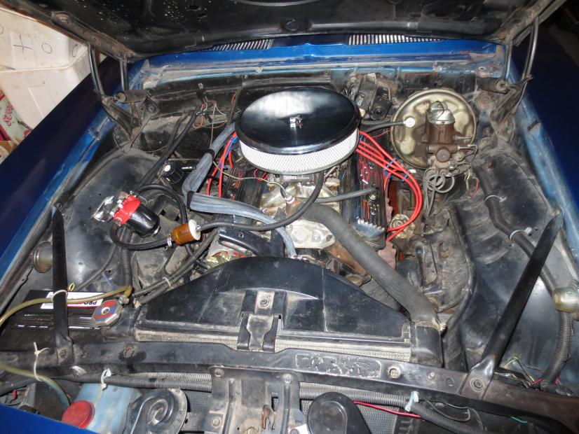

new member-z28-001.jpgfinally done from under the hood.New water pump and hoses , heater core seems to be ok. Replaced fuel lines and mechanical pump and installed backup electrical pump under fuel tank for the hot summer days for vapor locks. New plugs ,wires and distributor parts. Car is running really good.
Old Dec 17, 2014 | 03:28 PM
What happened to the original engine? You might want to rework that rubber fuel hose and plastic filter setup. Anything but steel or aluminum from the pump to carb is a potential chafing, cracking & fire catastrophe.
