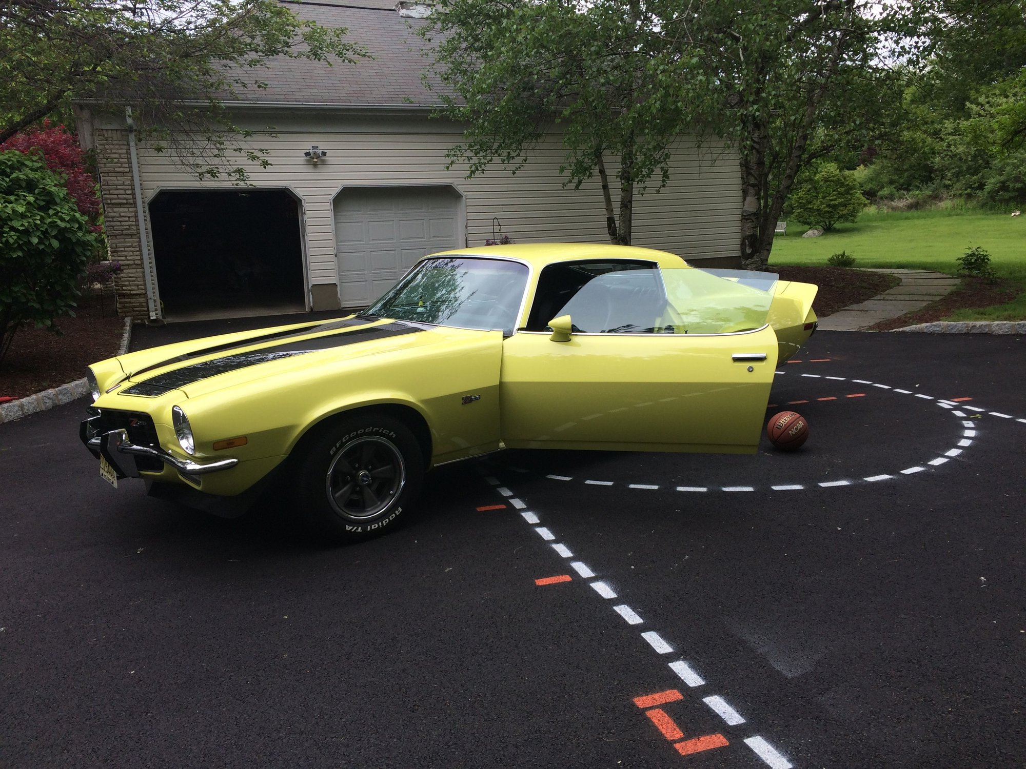

I have an complete original 73 Camaro. It is a complete numbers matching off body restoration. I removed the engine & trans and did a complete overhaul on the original numbers engine & trans. After boring it , I decided that the Qua jet original carb was not efficient. I installed a single barrel Holly Carb which works perfectly. When the car is very hot, engine and also if it really hot outside physically. I am noticing that the car / carb is choking. The car has no acceleration, bucks and chokes. Then its OK for a min. In the cold weather, there are no issues. Someone told me that the carb needs a riser and that this would solve the issue. Has anyone ever heard of this heat chocking issue before. I love the car and it is simply amazing.
