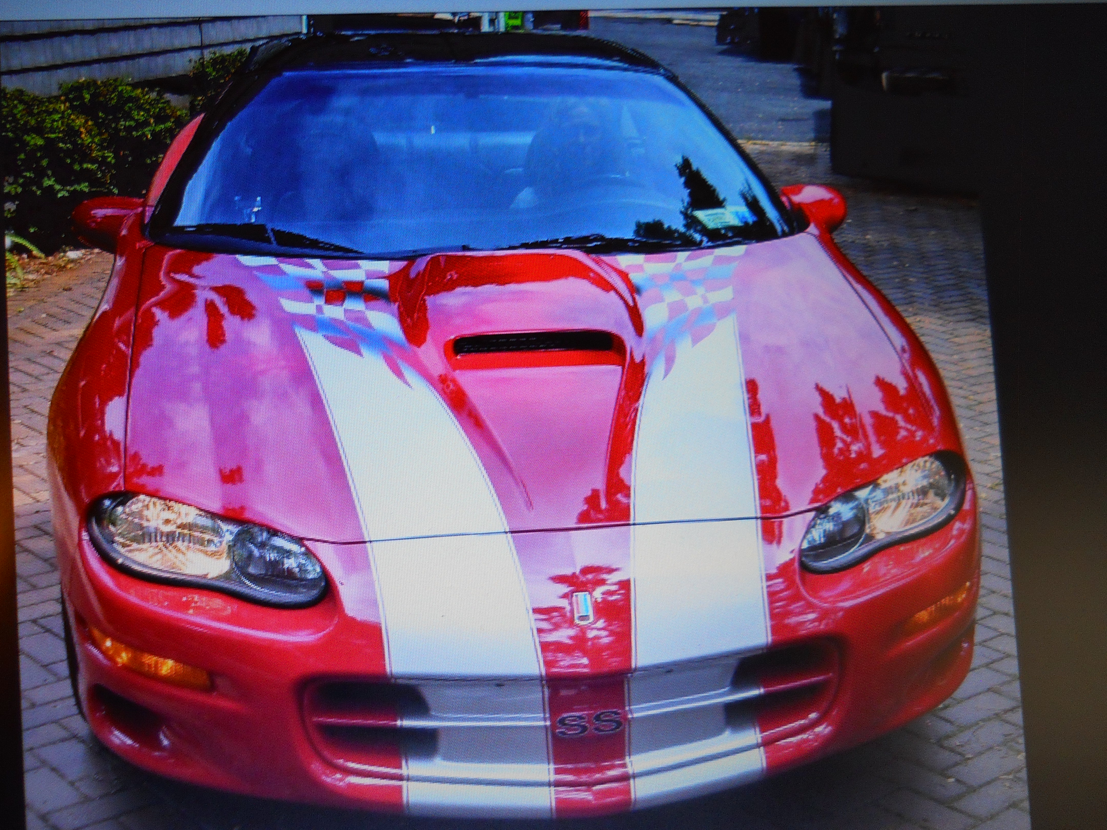

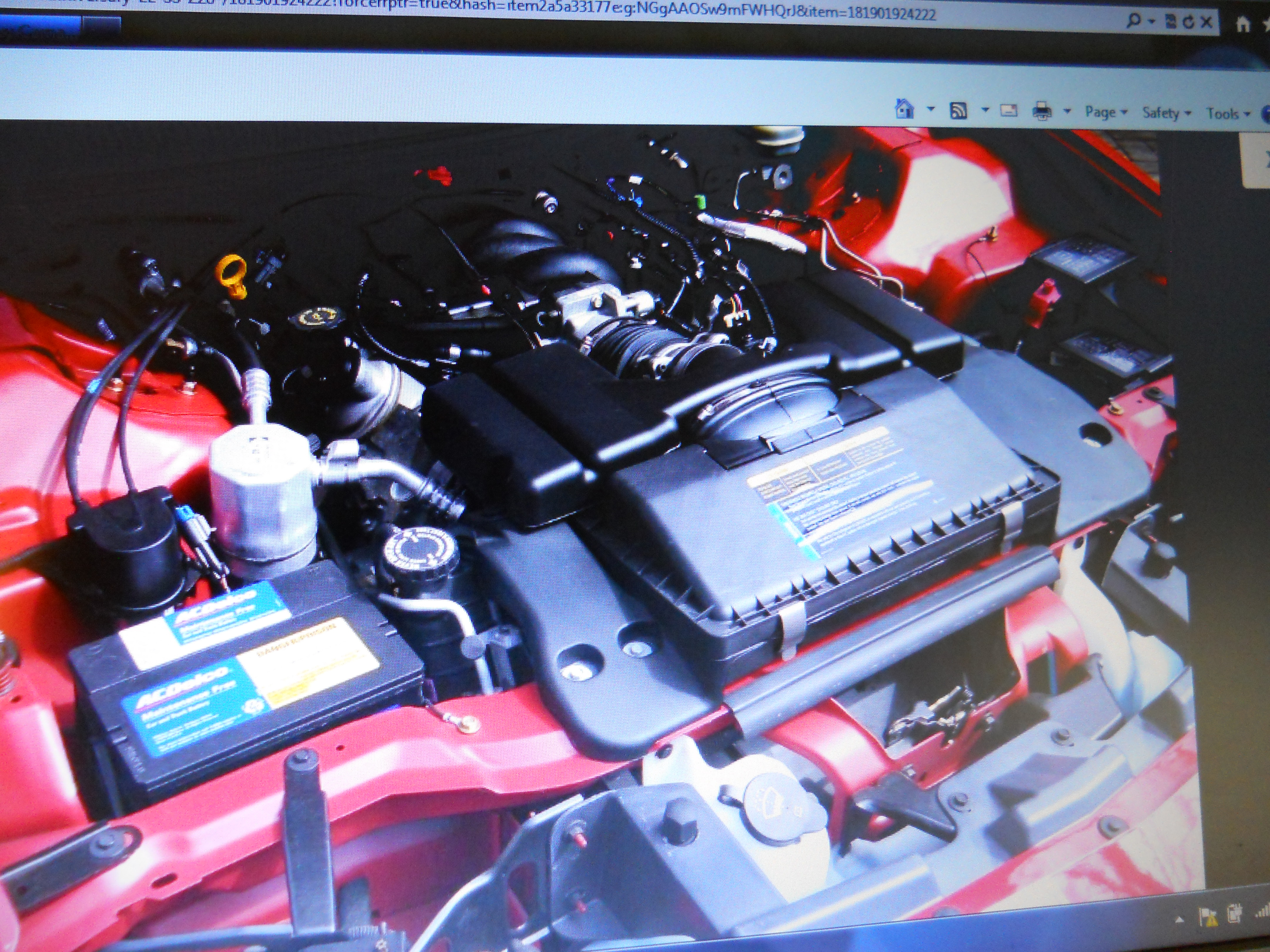

I see some 2002 this one $21,000 make offer 2034 miles its like better then showroom like i told you in your other post .if you got the $$ there car is worth it ,i would start at like $16000.00 see what the one owner women wants ,its sweet ,if i had the $$ its the one i would go for ,there 3 of them among other colors ss ,some are 35th edition marked an others not ,ebay could eat off the underside of the car ,an other with more miles lower prices all 2002,i think its # car 0nly 609 made ,theres a covertable with 58 miles 1 of 609 $35.000 ,for me i dont need a covertable for $15000.00 more an a few less miles ,want a head turner ,its the best deal i seen on that rare car
