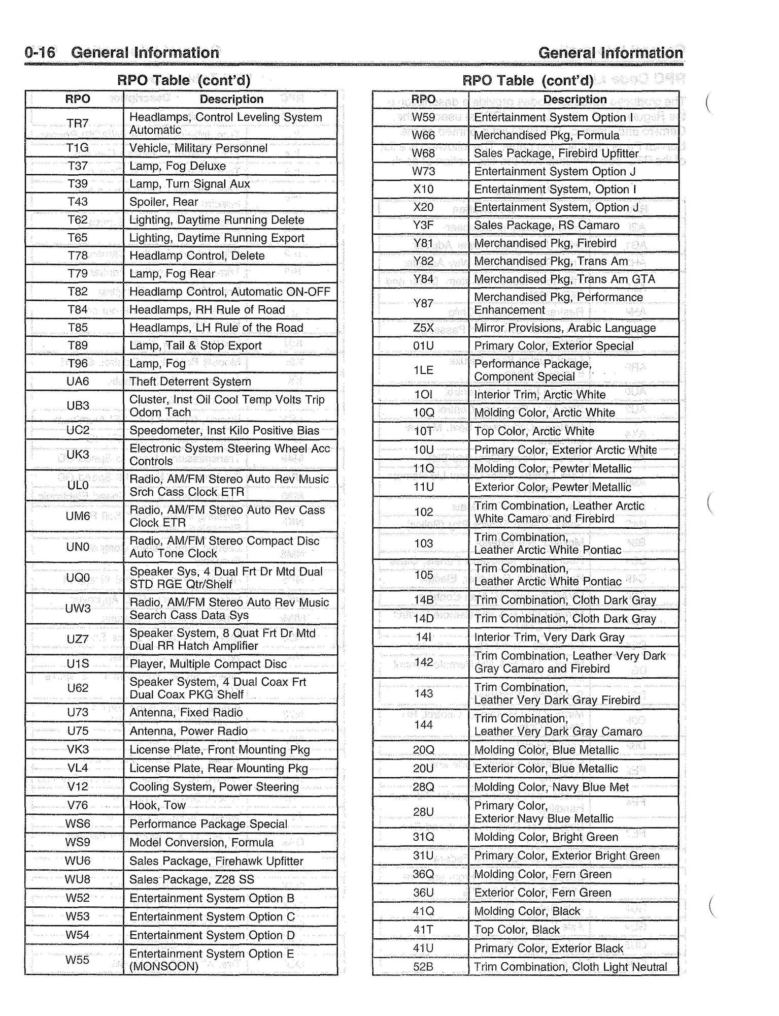

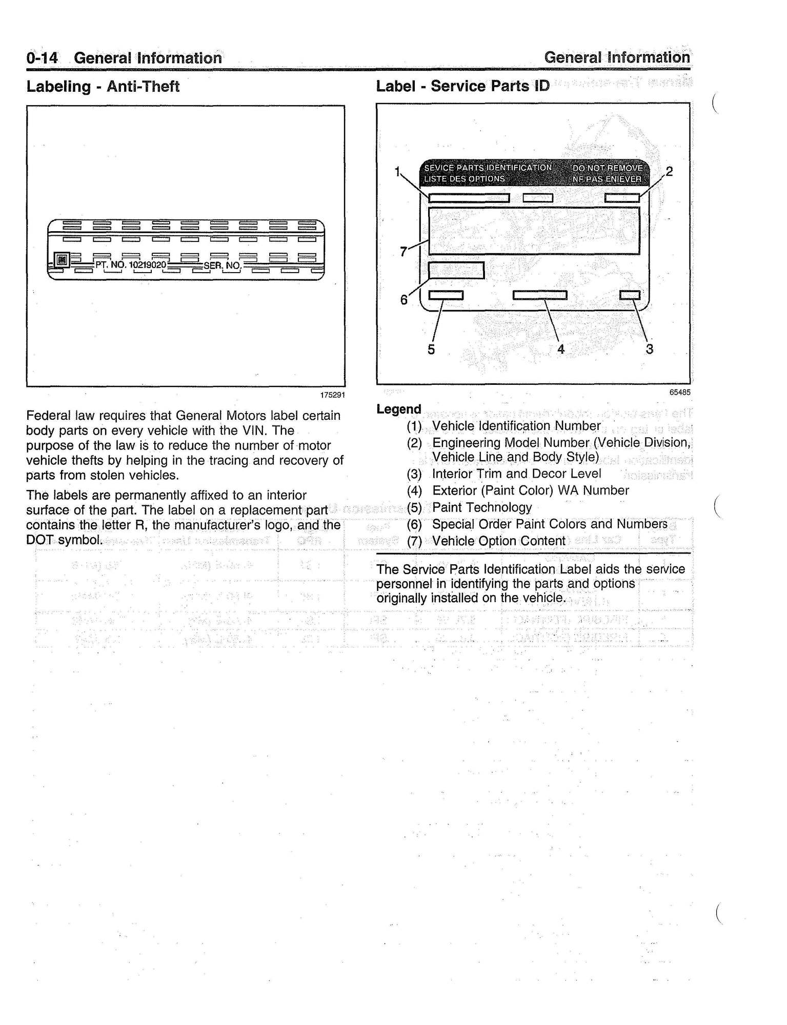

I made a typo. Should have said SPID Label which is on the driver door and list the RPO numbers for every option the car was built with. The pictures below are from the 2000 Service Manual and should allow you to decipher the three digit RPO codes. For example, VK3 is a front license plate bracket.
Thank you for that info. I talked to a retired NY State Trooper friend he said to put the front plate on the dash board. He said to tell the police officer that the car was bought in Indiana where front plates aren't required therefore there is no front plate bracket. He also said to beware though because it's a good reason to pull you over if he suspects there may be some other violaton!
