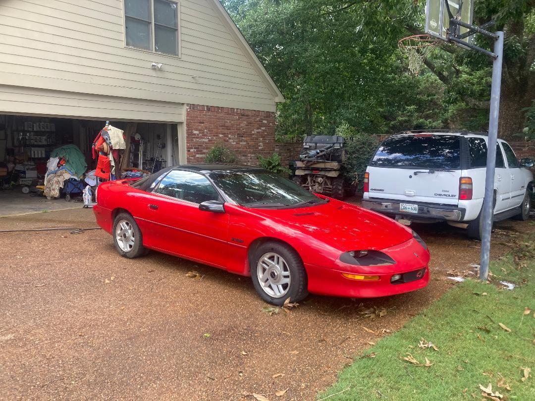

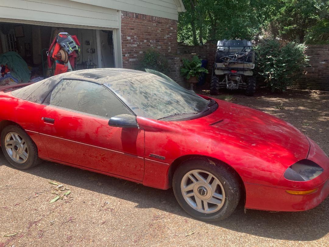

1995 Z28
Bought 4/7/96 to replace 88 iroc bought new
Installed New plugs
Oil/ filter
Sprayed cylinders with fogging oil
They turn over
New fuel filter
Drained gas
Put 1.5 gallons back in and drained again
It turns over, but won't start:
Fuel pressure injector gauge bumps to 42lbs when ignition turned on then falls back to 38lb
Spraying starter fluid in the throttle body will cause it to run until it burns out. I'm thinking it's some type of fuel problem.
any suggestions on where to go next greatly appreciated
