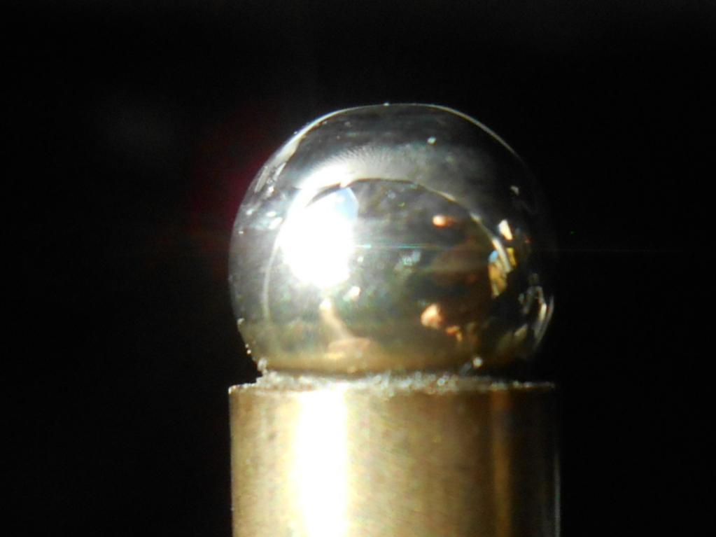

I have 2 LT1 cars. The first car (72k miles) has a stock roller cam witch needs no zinc oil additive. But the push rods showed lots of wear. Due to the lack of using a ware additive in the oil.
The 2nd. LT1 car (74k miles) the previous owner had used a oil with zinc (additive) in the oil and the push rods showed no noticeable ware. So, there are still a lot of engine parts that need a oil additive for reducing engine ware.
See photo.
See photo.
