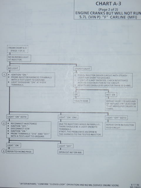

ahh ok. are you getting a security light? if so whats it doing?
Size:  61.2 KB Name:  P7150004.jpg
Size:  64.5 KB Name:  P7150006.jpg
Old Jul 2, 2011 | 11:35 AM
gagger84's Avatar
Posts: 159
From: Minneapolis, MN
Thanks for the diagram, I'll definitely read through and see what I can find.
