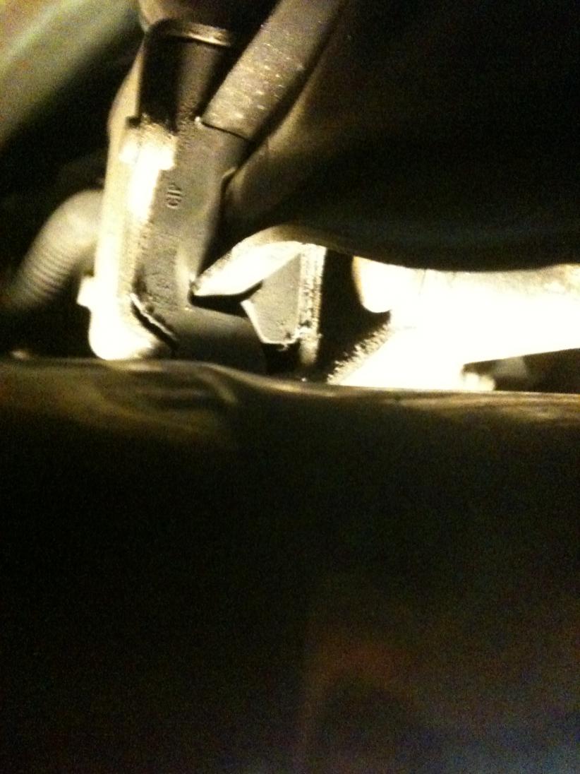

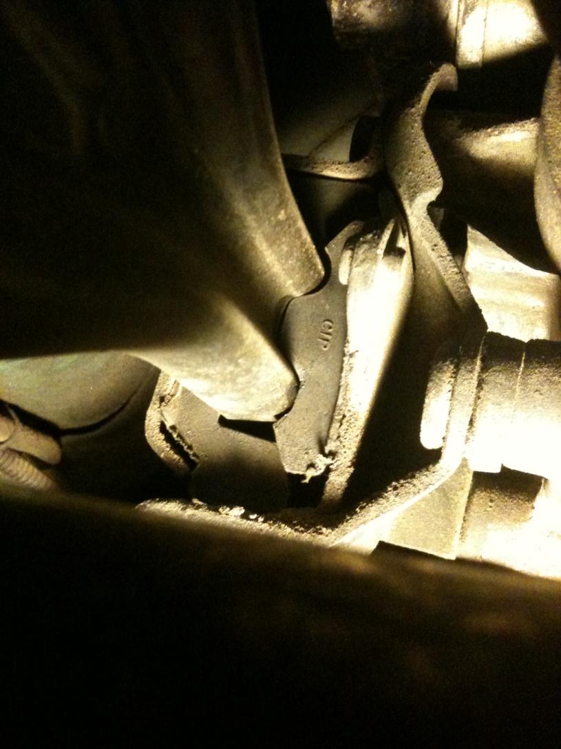

well i just went and checked. it was 28 1/2 inch on the drivers side and 28 3/16 on passenger. both tires have the same pressure. could the difference have somethng to do with it? and these are the best i could do with the torque bushing.

the bushing doesnt look right, i would take it out and see if its all tore up.
that stock or higher, what is your tire hight? the 4th gen sets about 1/4 to 3/8 in higher on the driver side so your normal there.
