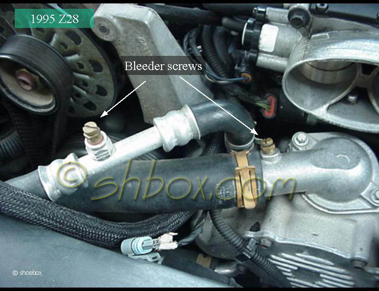

What year is your car? There are two bleeder screws, one near the thermostat housing and one at the T for the heater hoses.

It's a 95 and I am thinking I bleed the one in the T, is the T about 6 inches to the left of thermostat housing,if it is that is the only one I bleed.

early 4th gens have a bleeder screw under the thottle body as well.

Thanks the picture helped ,it was the upper one I bleed.I am going over to the garage tomorrow to work on it and I'll bleed the other one.

make sure the radiator is full while bleeding it. park the car as steep a hill you have in your area, park with the front of the car on the up side. let cool, fill radiator, with the radiator cap off open the bleed screws one at a time and close them when coolant comes out. refill radiator as needed. the bleed screw on the hose will not bleed until the car is started. soo once you have bled the lower screws, mine has one under the tb, one on the thermostat cover and one on the hose that is next to the alternator, this is the one that will not bleed without the motor running. anyways once you have fluid coming out of the other or others, close them and with the cap still off start the motor and bleed the hose screw till fluid comes out, check coolant level in the radiator and fill if needed and put the cap on. take the car for a ride around the block and rebleed the screws without removing the radiator cap. then let it cool and do it again from the start to see if air is still there if so repeat till you get no air on the re bleed.
