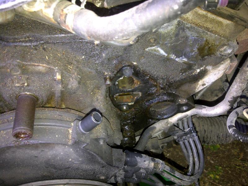

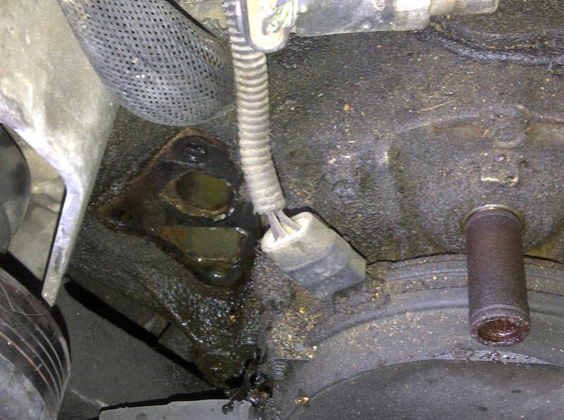

Yea thanks for the help! lol no I found the firing order but I really need to know if I can get this thing wet, well more like drenched. I am planning on renting a pressure washer to clean this thing off really good but I don't want to damage anything. I know the SBC like the back of my hand. The HEI ign system is very simple and I know what I can do to keep it from being damaged by water. Keep the plastic cool and don't start for a little bit after I have cleaned it. Will this work for that dumb *** opti?

Take your plug wires off and wrap the opti well with a plastic bag. For fear of water getting past the seal, you don't want to get the opti wet, especially with a pressure washer. Are you replacing anything with the opti while you're there (whole unit, or at the very least the cap & rotor)? If your opti has never been serviced, you might be surprised (maybe not pleasantly) at how it looks inside.
