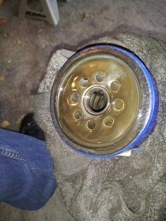

if oil was low and it got air in it you would lose oil pressure. is it ticking or knocking. ticking could be because of loss of oil pressure. front and rear intake seal is common oil leak on lt1. car dyeing could be opti goin, i would not be so fast to condemn this one. how about some pictures

was changing my oil just now and something doesnt look right lol. thoughts?
