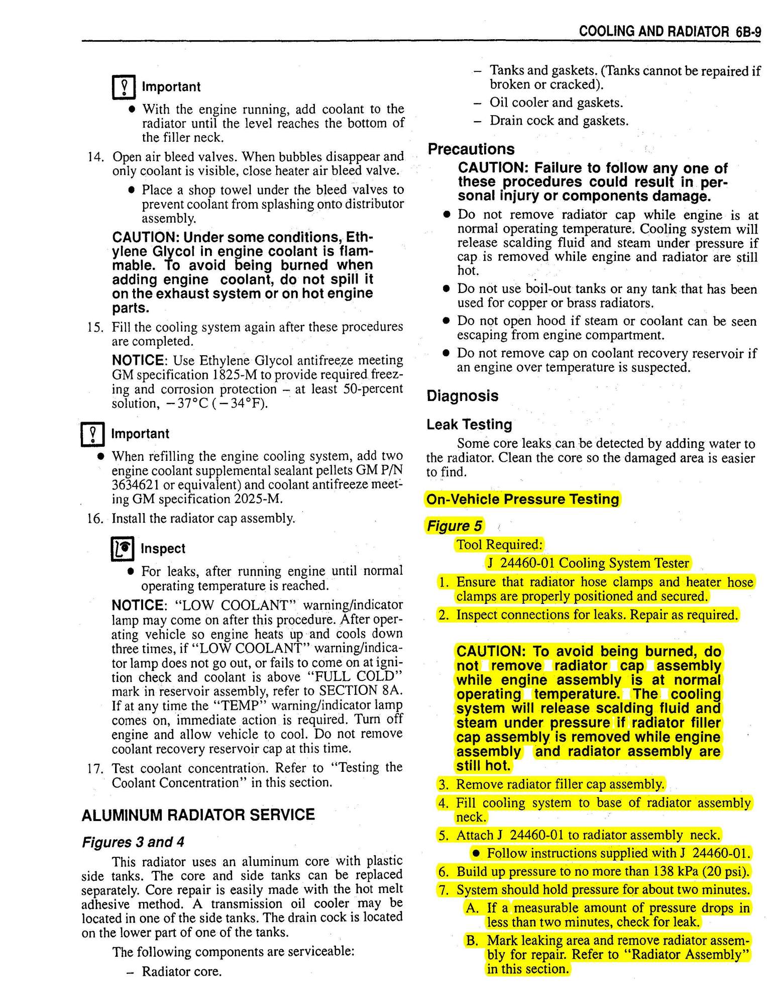

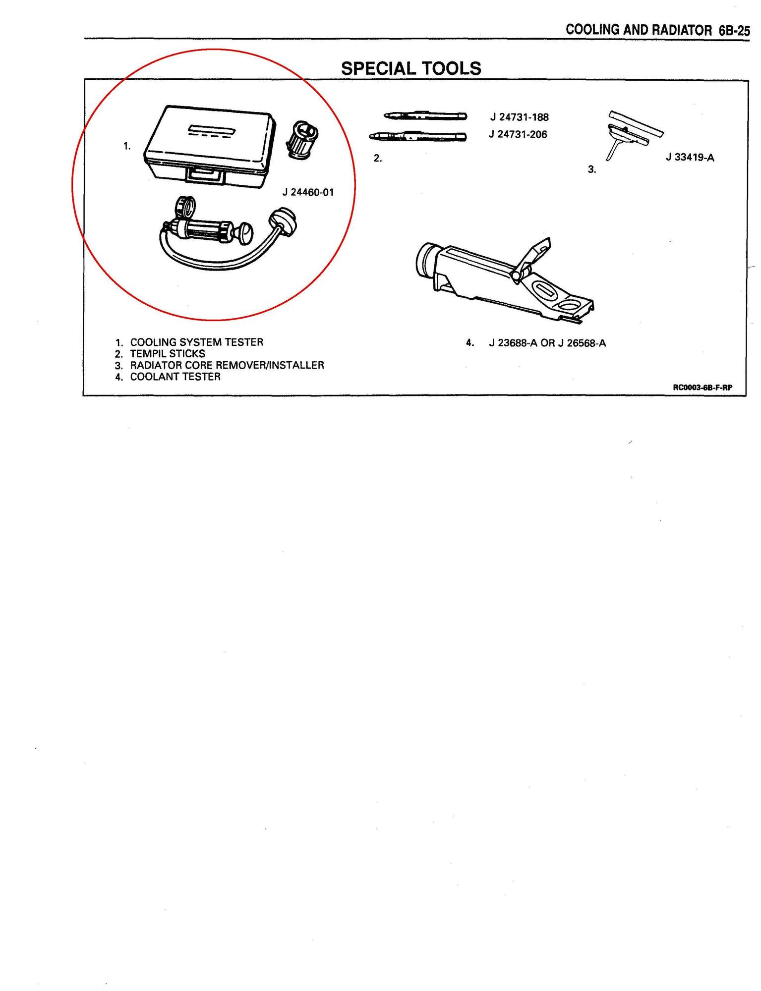

Originally Posted by dgriffi2
It’s at the shop now, should I ask them to do a pressure test? What does that entail?
These pages from the 1994 service manual describe pressure testing the radiator. This tester will also test the radiator cap, so if you have them test the radiator, I would also test the cap.
