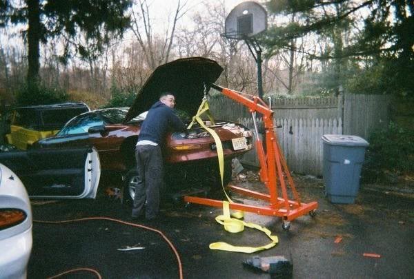

What Craby said. If you pick on my 93 Camaro build thread and scan down to post #11 down you can get an idea what it looks like. Once the K-member/Engine is disconnected the body is lighter than the engine. In my pictures I am using the light Harbor Freight's cheapest/smallest engine lift.

If you pick on my 1993 build thread in my signature and go to post #11 and 12 you will see the car sitting on jack stands with the nose up and you will see the engine with the K-member sitting on a wooden dolly along with 2 wheel dolly. The only thing the wheel dollies are doing is allowing me to move the frame in any direction. The wood dolly is carrying 90% of the weight.
If you go to post #14 you will seem me lifting the body off the jack stands after the motor is in place and the next picture is right after the I lowered the car and moved the lift away.
For a stronger guy that knows the process and have the right tool but no lift I would say this is a 8-10 hour job. If I did not have 3 crushed disks in my back and I had a real lift I could do the job in 6-7 hours. This was only my second time doing this and with my back it took way longer. Keep in mind I use to be solo in my garage.
When I did my first one I did a ton of research. Even then there was a big argument on which way was easier. I had always done "out the top" on every other car I have done. I was able to find dozens of build threads. One thing I focused on was guys that had done the process both ways. Every signal one of those guys said they would never go out of the top again. The issue is you have to strip the engine almost to the long block and remove the radiator. After helping a friend remove is exhaust manifold to install headers I remember thinking that just that was worse then removing the motor out of the bottom.
I though about upgrading my cherry picker because I was picking up a car but I did not. I put some jack stands under the axle so the car could pivot around the axle. I notice the cherry picker lifted the car with less effort then it did lifting the engine and trans out of the k-member. One piece of advise I would give to the OP, Make sure you have plenty of room to maneuver the engine on a dolly. That is why I backed the car in the garage. I could pull the engine assembly right into the drive way.
