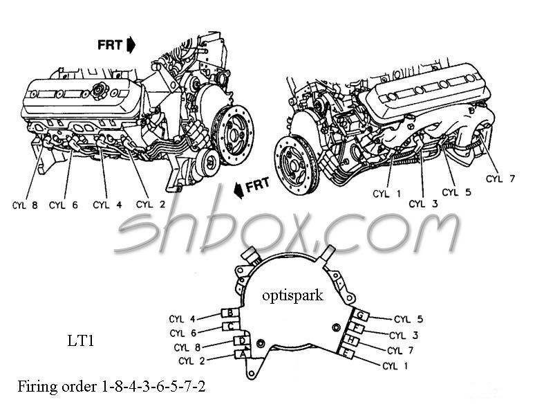

make sure they used the correct lt1 wiring. there are two different orders, there's a different order on the iron head lt1 that I have seen guys use thinking all are the same. I did all my work myself but now too old so I been sorta looking around here for a helper myself. I live on the coast so dont know any shops in sound area.

Well it was a good thought, but all eight wires are going to the correct cylinders per that diagram you shared. I'm fresh out of ideas at this point.
