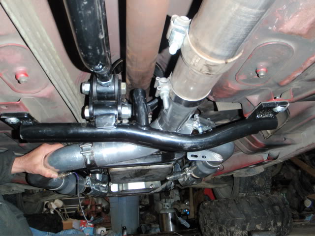

ya know i really dont think you will lose low end power. power range has more to do with the cam. i beleive u will gain high end power. im not real sure on the clearance with the pacesetters but the kooks i have are not that much different than the stock exhaust concerning ground clearance. the y pipe is the piece that will be lower and the kooks is a oval shape in the right areas. again not sure of what the pasesetters have. as you see the driver side is the low side and is not much different in clearance than where the cat would set. i do have problems with the crossbar for the torque bar that i added. it will hit on speed bumps if i have a load or its a really tall speed bump. my car is lowered about an inch by the way.
