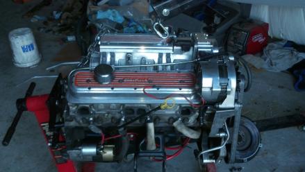

Just an update to anyone that helped with this page. I appreciate all the help, but in the process of fixing the car I came across a lt1 383 stroker 9:1 compression and went that route. So now it has a t70 turbo home grown rear mount. I'm sure i'll have several question during the process of fine tuning this car but I wanted to thank everyone for the help!
