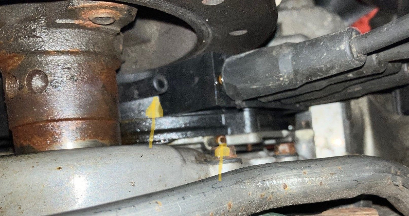

Seems I have the vented Opti but who ever installed it though the pluming was surplus , another thing to add on the todo list sigh....
Opti air connections

Found the Opti air connection on the intake to be plugged, so previous owner deleted the pluming on purpose obviously.
So the option being a 93-94 engine is off
