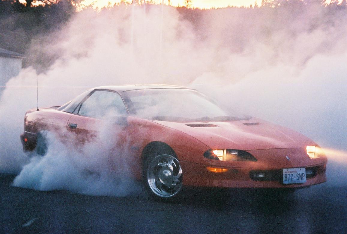

i am a newbe so forgive my mistakes if any. i have a 93z (my second)that has been testing my abilities. it seems to be running rich, low power at low rpms and has a rough idle. got all the oil and vac leaks fixed. (i hope) intake, oil pan, timing gear cover seals. changed opti, map, chged intake manifold to a air gap edelbrock, stock one was cracked and the air gap has a clean look and easy to find leaks if they develope. also new plugs and plugwires timing chain and gears and oil pump. i will be changing the lifters to see if thats it with some less costly ones until i can afford a cam kit . i have some noisy lifters and am pretty sure two are bad. i have good oil pressure little over 20 lbs at ltle warmed up. next step?
