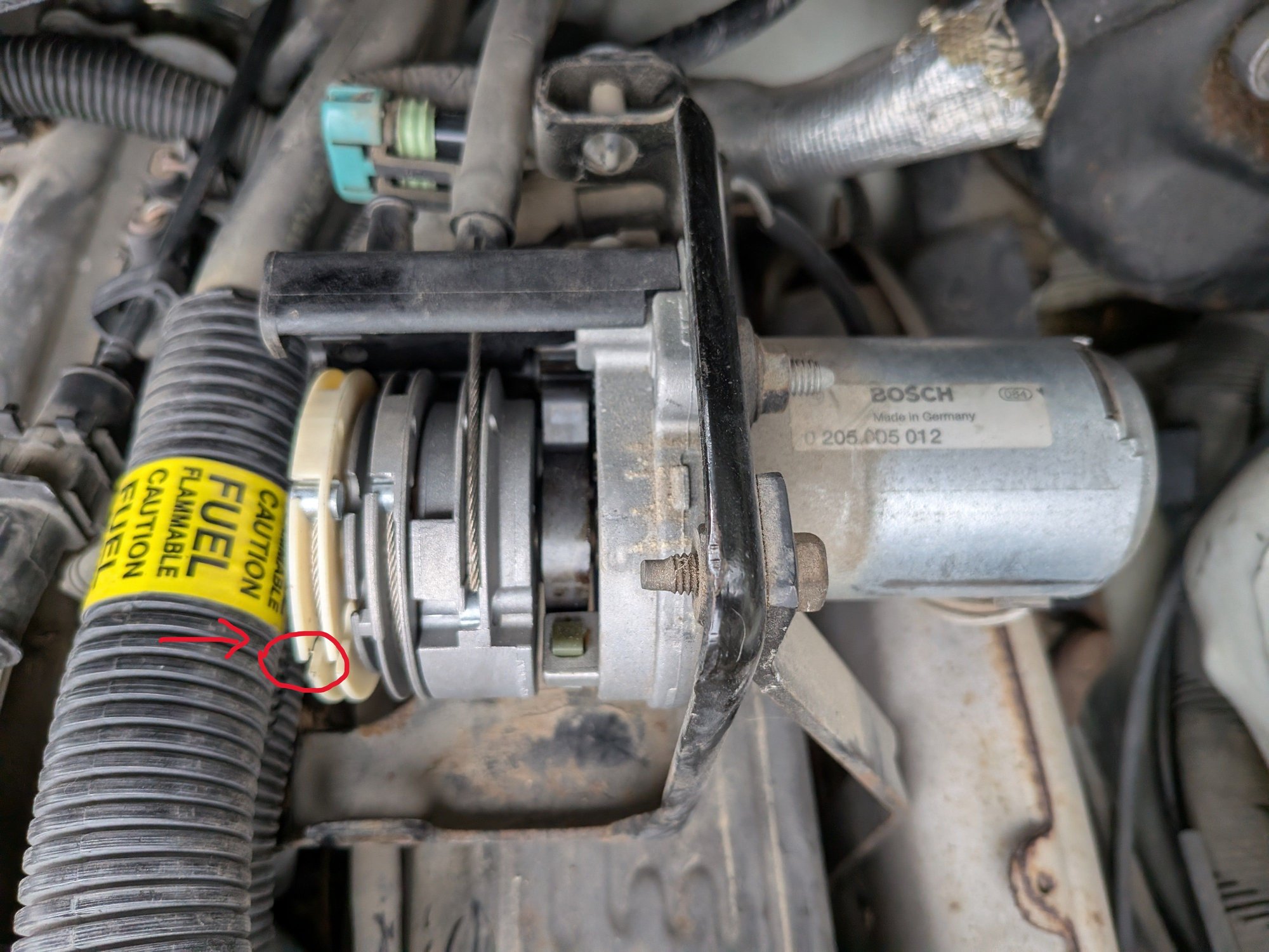

Originally Posted by jrgearhead
Okay so on my driver side valve cover there is a bosch gas pedal accelerator according to what i found when i searched the part number 0205005012. My throttle cable runs through it. What the heck does it do? and do i need it?
did you ever end up doing the switch to just a throttle cable? And if so how did it work out? I was looking into doing it myself but not a lot of information out there..

Originally Posted by Green97
I don't think he's gonna answer. He was last on this forum in 2012...
can anyone else chime in on this? Really considering just getting another unit altogether even though i feel like it would be a waste if i can modify.. my asr unit initially was intermittent, but now wont go past 2000rpm, its definitely the asr motor but its my summer car and i dont need the cruise control or the abs.

Exclamation 4th Gen ASR TCM Module problems
I'm having the same problem, and it feels like parts places have no idea what I'm talking about. I did "fix" the low-rpm issue today; it seemed like the cable had come off the track. Now a bigger issue is that if it came off track due to the motor being bad, but I did have success with just unplugging it after and just dealing with the annoying ASR light.
