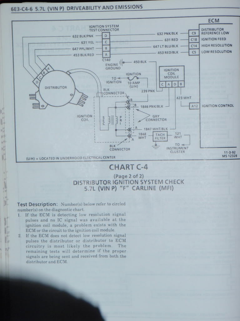

Old Jun 13, 2013 | 02:57 PM
Posts: 22,042
otherwise i would say its most likely the opti or ignition control/coil module although im sure theres a few other things that could cause it like failing ecm/pcm. heres some info to test some of the ignition

Old Jun 13, 2013 | 06:28 PM
I've had a bad opti before, and the rpm's didn't bounce around at all. A bad ignition module however can make the tach jumpy. That's what I'd suspect, with it running crappy and the jumping rpm. That's best guess though, without checking the error codes.

I replaced the ICM with a spare my cousin had from a rebuild and I found a vacum line from the opti disconnected. Runs like a top now. Thanks for all the help!
Old Jul 13, 2013 | 07:15 PM
Posts: 22,042
i would say the icm was failing. vacuum line is just for vent.
