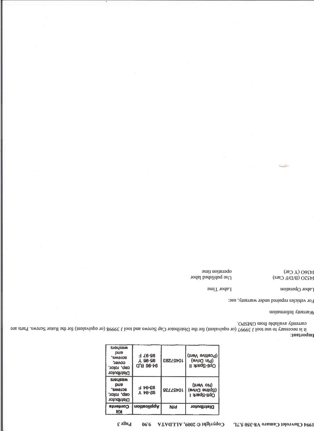

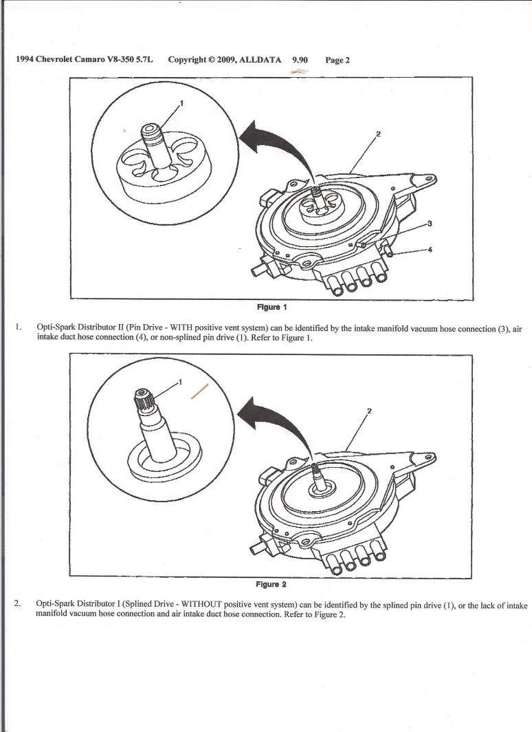

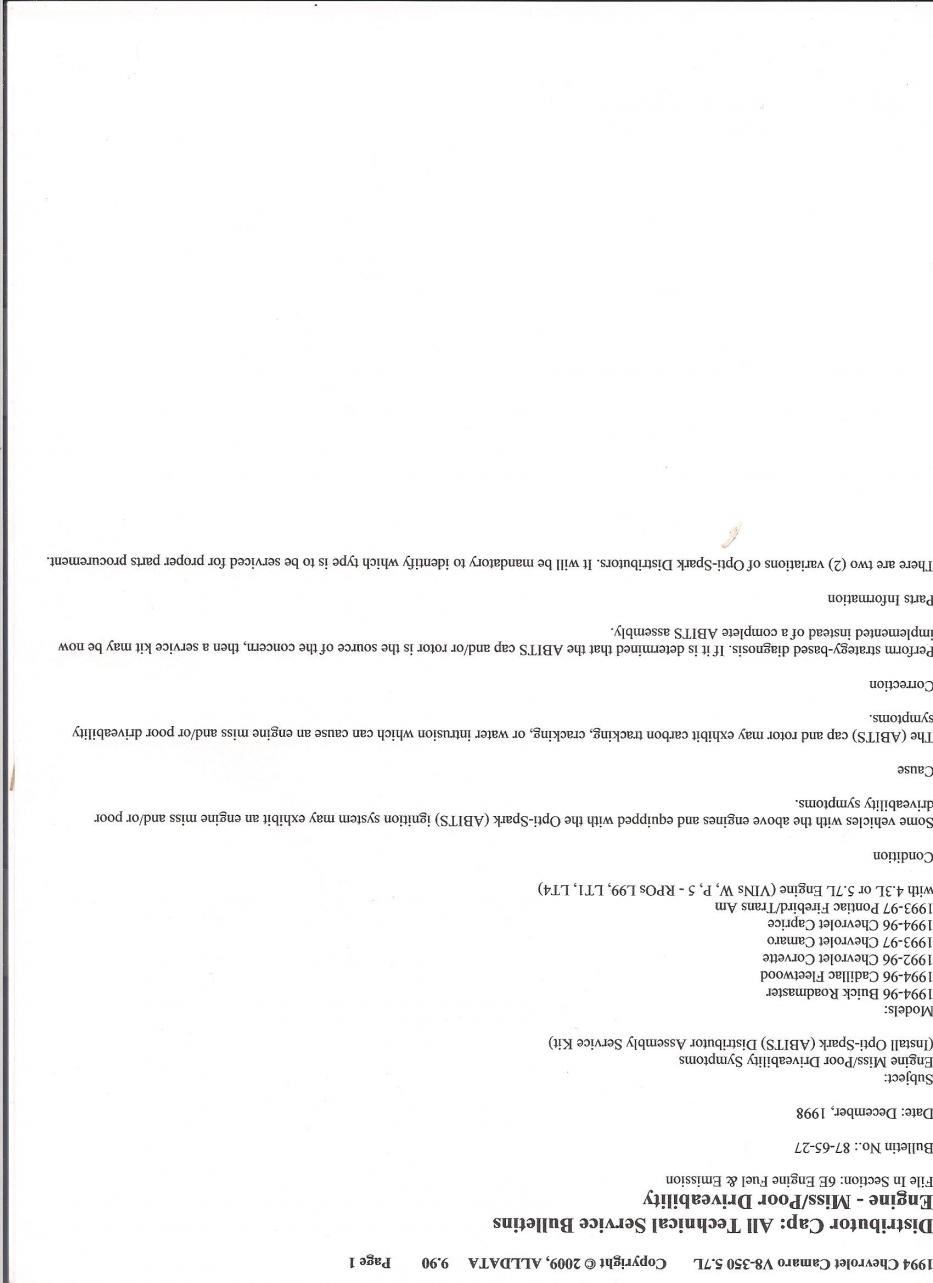

alldata shows the differance and they arent interchangable but ive heard of people making them work. if anyone knows how i can post pics from alldata on here i would be more than happy to show you how they are differant

here you go, had to scan printed copys lol
Attached Thumbnails 93 lt1-opti-differances-001.jpg   93 lt1-opti-d-001.jpg   93 lt1-opti-differances-1-001.jpg
