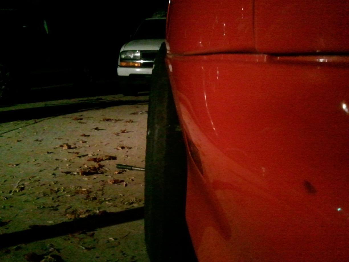

actually the tire sticks out past the fender alittle. Its a 5.5 backspacing rim. I'll take a pix

Like I said before, its not the body squatting thats going to be the problem, the real issue here is the tire growing when doing a burnout/running down the track. Anytime you run a bias ply tire, it will grow outwards the faster it spins/the hotter it gets.

Yeah, Im worried about the growth also. here is a pix from the top, it sticks out 1/2 of an inch.
I guess all I can do is punch it and hold it for a few and see what happens....lol
