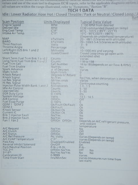

heres the typical values. it says .4 to .9 on the tps and 5-50 on the iac count.

Well I took my little auto xray out and messed with it. Got the TPS to read .54 @ idle and 4.94 @ WOT, but that didn't solve my high idle problem. But then looked at the IAC readings and the learned was at 36, but the other one was at 120. So I didn't know what to do so I was just messing around and turned the sensor 90 degrees to where the clip for the connector was facing up and it went from 120 to 0 and the learned stayed at 33-36. And that seemed to fix the problem. Now it idles around 900-950 RPM, a little higher than a normal Z's of 800. And at the .54 @ idle it's reading 0% trottle and at the 4.94 it's reading 99% idle.
Craby, you see anything wrong with this.
Old Jun 22, 2010 | 01:44 PM
Posts: 22,027
sounds like the iac is sticking or may have connection issues. whatever works, i have idle issues with the 58 mm tb i have but it seems to have learned. it may help to set the minimum idle setting. while not running you put the system into diognostic mod so the iac is closed, mine i just short the a and b terminals, then unplug the iac and set idle at about 500 rpms, shut off and plug back in.
