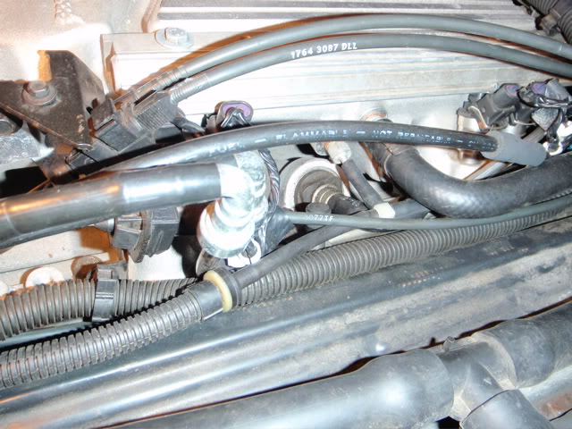

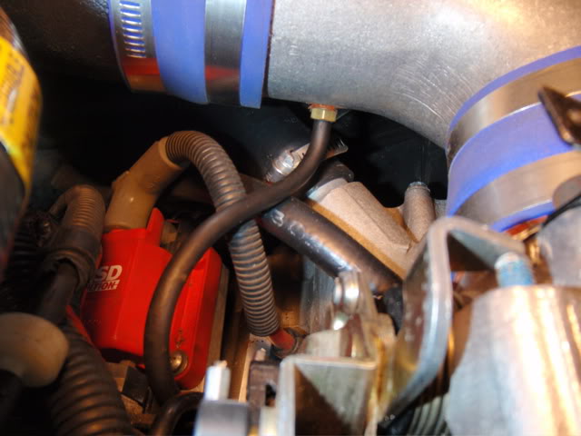

a 97 has a vented opti so u should have all the hookups. not sure where there at on a 97. the conversion i have on mine from the msd kit had a plastic fitting that pushes into the rubber elbow for one hose and the other goes to a vacumn hose on the driver side of the intake. they supply a little t fitting and the L fitting that goes into the elbow. its late and i didnt want to jack up the car to get a look under at the lower vent hose.
i have a aluminum elbow on mine now, i drilled and tapped for the brass fitting. this hose goes to the top vent fitting on the opti.
see the hose with the yellowed and black one way valve that goes to the white tee. that goes to the lower vent fitting on the opti. i think it has a adapter to go to a bigger hose to fit the lower fitting.

Ok... Im gonna go look at my car today, but I believe the top vent hose that you have picutred with the fitting in it (2nd pic) is the one that is capped off on my car... so I'll run a vacuum line from there with a 1 way valve to the opti, but are there supposed to be 2 vents off the opti, or only 1 with a "T" fitting and then 2 lines fromt the "T"... One to my "capped off" line and one to the intake? I'll take some pics when I get to my car after while and post them tonight... I just want to make sure that when I have all the parts together I put it BACK together correctly... Seems like the guy before me didn't pay as much attention to detail as I do...

yes there are two vent fittings on the opti. one at the top that comes out of the aluminum housing and one towards the bottom on the cap. the hose in the bottom picture goes to the bottom fitting on the cap on mine.

Ok... So now the picture you're painting is becoming more clear... I want to make sure Im 100% right before I go to the parts store today/tomorrow.. I have a stock intake, but it has an elbow in it... a piece of hose goes from that elbow to the cap, and a piece goes from the hose you have the 1-way valve to the top of the Opti aluminum housing? Im sure once I get the old opti off I'll have more of an idea of what youre talking about... or once mine FINALLY gets here today... I was under the impression that there was a "T" somewhere, but I cant figure out where there is a "T"... Just making sure.... You know that whole "measure twice, cut once" thing... Im glad you're not gettin pissed off from all the questions... Some people aren't very patient, and I greatly appreciate all the help and visual aids...
