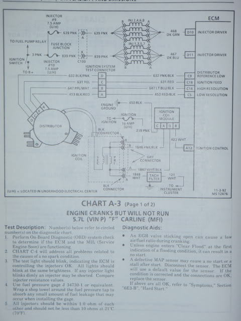

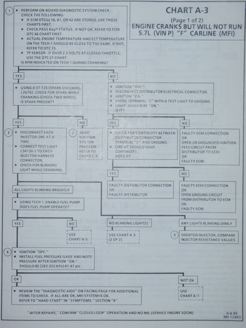

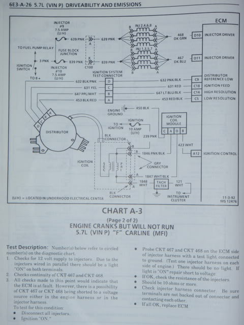

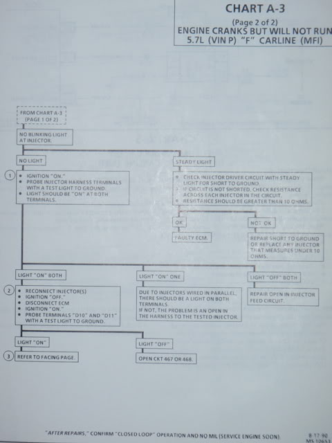

what are they scanning it as? remember you have a obd 1 ecm and obd2 plug. it may be that you have one of the rare obd2 systems that were used in late late 95. first thing that comes to mind is the igniton coil modual or coil so you have already done what i would have. check for any lose grounds, when it wont run you should be able to back track to find were the power stops. could very well be the ignition switch. have you seen this, its for a 93 so some is different than yours, not much though so most tests should be good.
Thank you so much! I will start troubleshooting using these charts. I'll let you know what happens.
