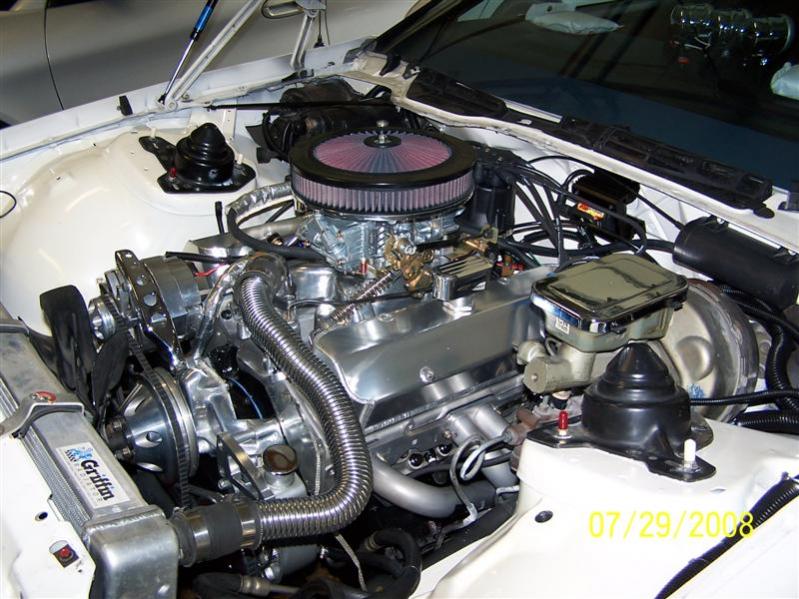

Hope you like it as much as I do mine. I built mine last summer and it runs strong and fast for sure. Mine has the stock bore with the stock crank and rods that were reconditioned with ARP and Milodon studs and hardware. I run a retro hydraulic roller cam with 1.6 full riller rockers that give me .563/.574" lift. I amusing Dart Pro 1 aluminum 200cc heads. Here's a pic of mine when I first got it in the car. I am in the process of doing 3" Flowmaster system this winter. Have fun and enjoy the power and torque..
