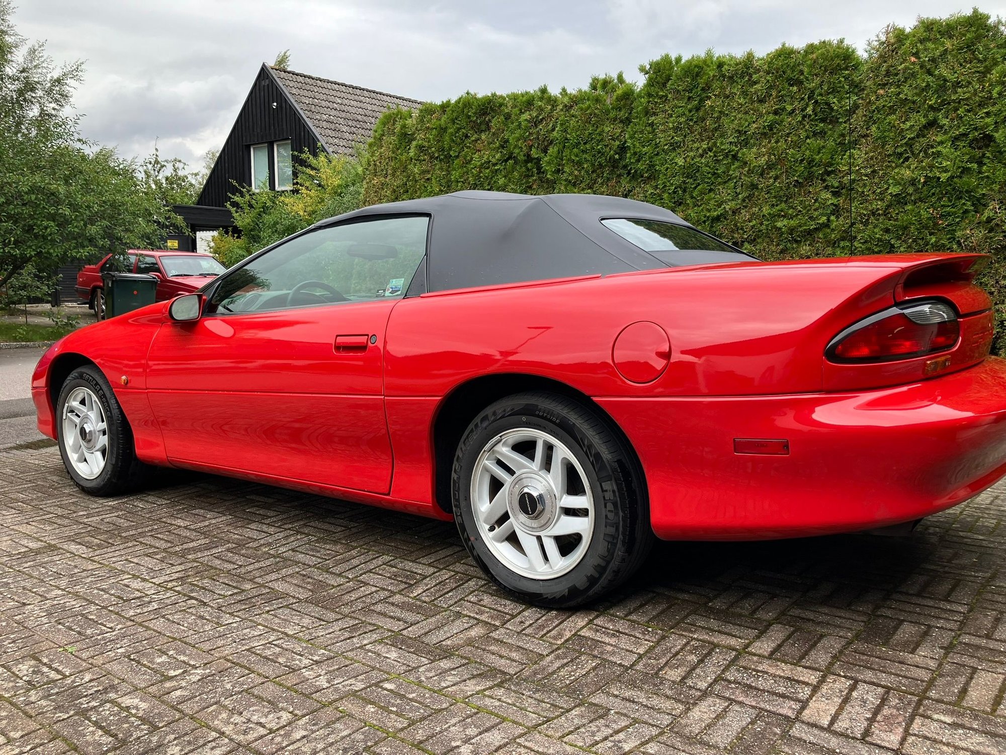

I wanted to keep the stock 16 ‘ rimes, mostly because I think they look good on the car, but partly also because the majority of the 4gen runs on aftermarket rims.

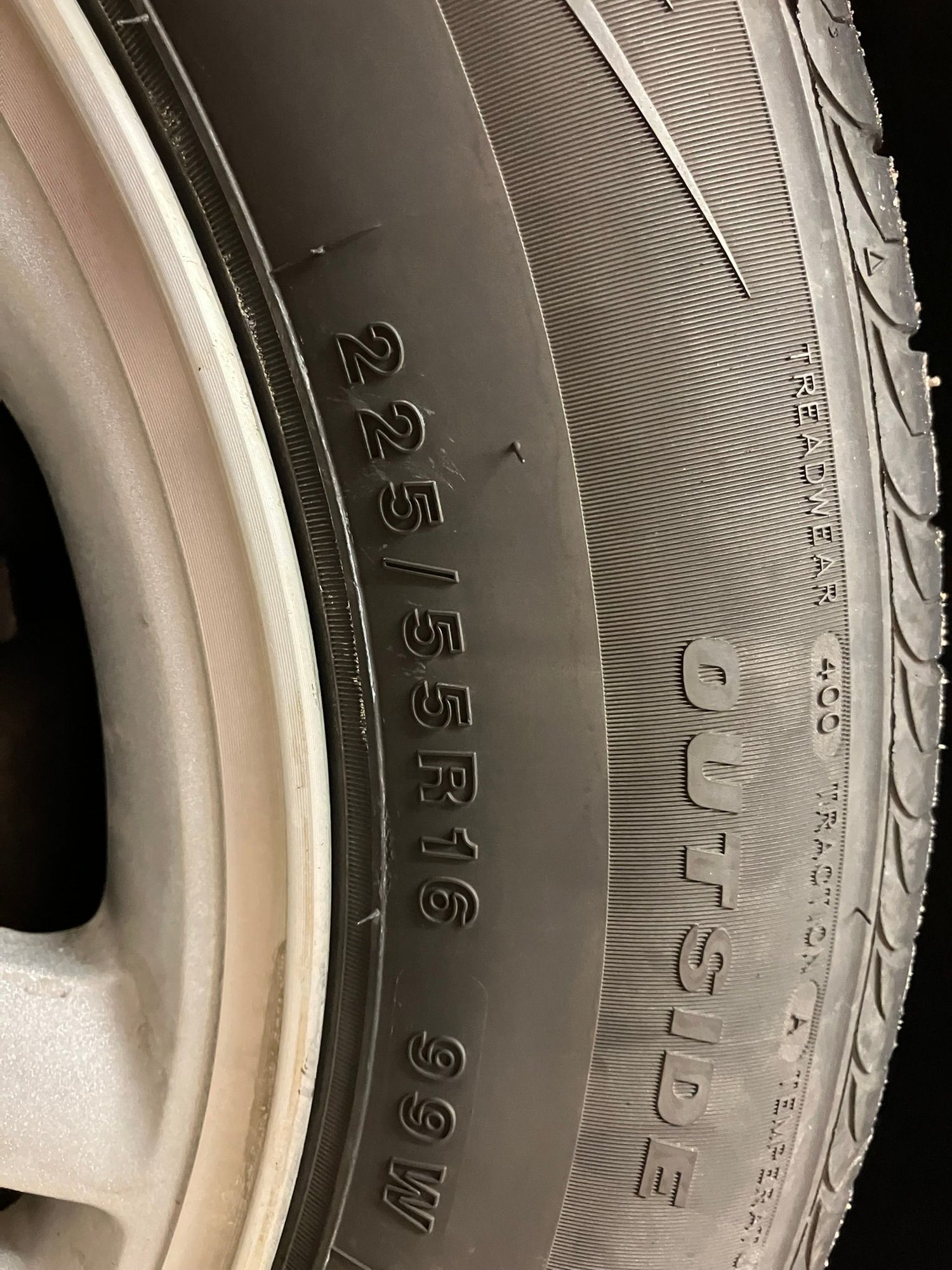

Car came with 235/60/16 on when I got it, which was good for potholes but made it sit oddly high and had plenty of age cracks, so needed to be replaced regardless.

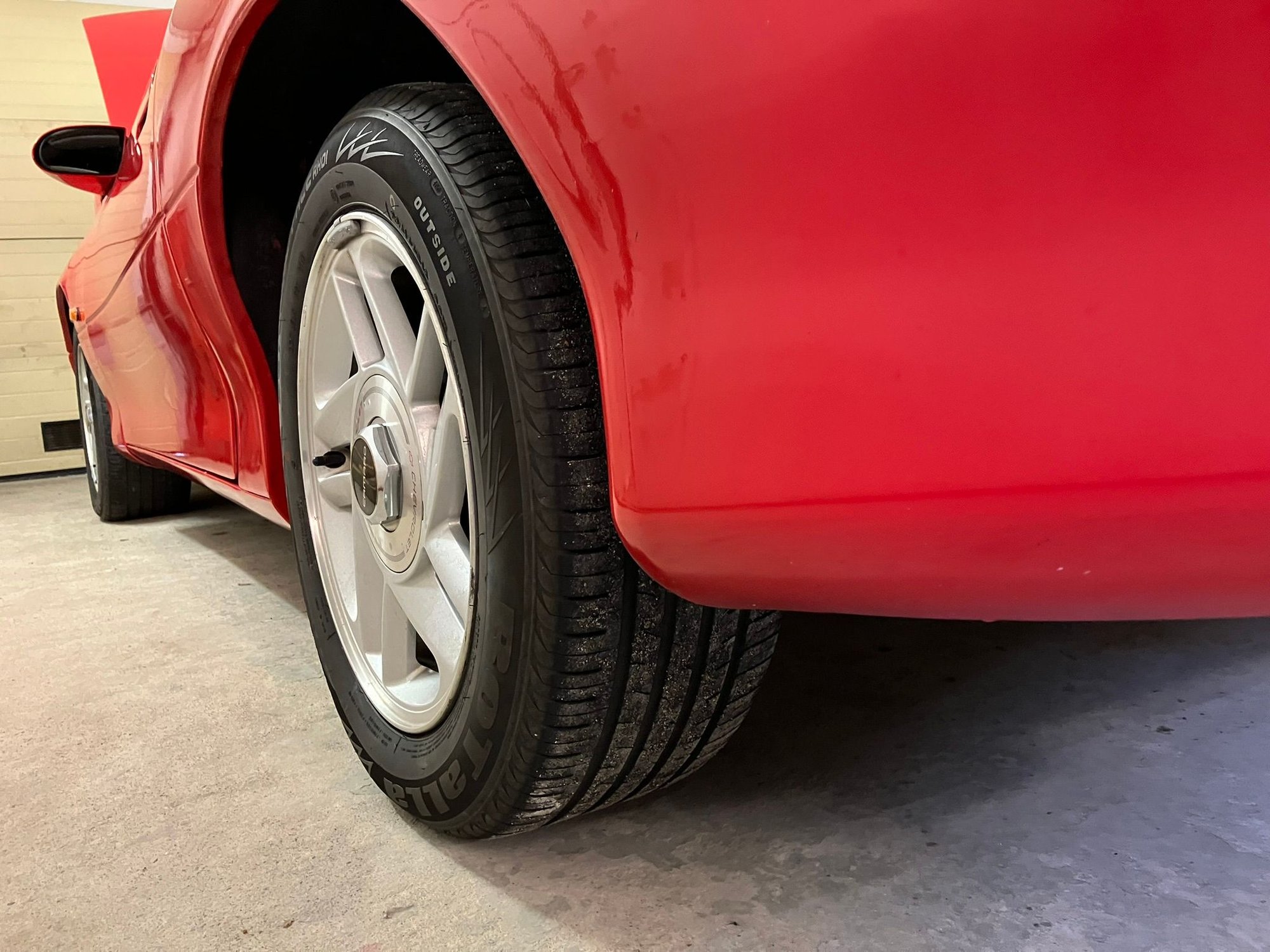

The original tire size 245/50/R16 is from what I understood pretty obsolete and hard to find anymore, aiming for the same height as 245/50/R16 (122.5 mm) closest was 225/55/R16 (123.7 mm) which first seemed way too narrow, but as I had a chance to buy a set of nearly new one’s real cheap, I decided to give it a shot which so far has turned out well.
The car drives good on the road, stable at higher speeds and fully ok roadholding for the normal driver.

Yes, that size is available, for ex Toyo Proxes costs 460 cad, and Micheline for the double
I choose the
225/55/R16 option to get the right height on the car, but partly also because I was curios of how the car would drive on that size, but mostly as it was cheap solution that will save me money for other parts needed to this beast
