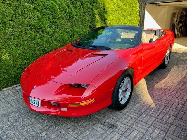

I’ve been trying to find the color code (exterior) on my car, not sure if its among the RPO’s or not, and can’t see any labels in the door jams, and VIN decoder result didn’t reveal anything either
The car has been repainted for sure, no eyeshadow under headlights and I’m missing the Z28 emblems, but I believe the color might be Bright Red 81U
Any inputs or opinions appreciated as I plan to buy some touch up paint and want the right one

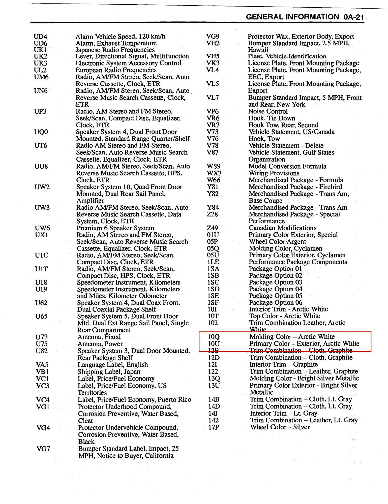

This page is from 1995 Service Manual that breaks down the Service Parts Identification Label you posted. In your case the paint code for 81U should be U 3567

So far I've been unable to decode what color U 3567 is, all the exterior color RPO's I have found have two digit numbers followed by "U", but I likely need to investigate more to get a full picture.
When I had the car up on a lift recently, I spotted some dark blue-ish metallic paint on the bottom edge on one of the the rear fenders that could have been remains of the original paint, and looking among available exterior colors for 96, that could be Quasar Blue Metallic or possibly Dark Purple Metallic.

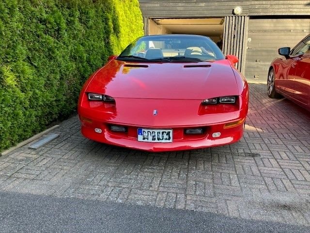

However my main objective right now is finding the correct touch up paint for the red color the car currently is in, so what I was fishing a bit on in this thread was the likelihood it has been painted in
Bright Red looking from the pictures, totally understand no one can say for sure but those who have seen several bright red cars in real life might be able judge and have an opinion.
I was also thinking on turning to a paint shop that have the kind of scan tool that can read the color on the car, and then make the right blend, probably costly but also the best way to get it spot on as it compensates for the slow color change caused by the sun and age.

I should have taken the time to decode a few other RPO's in your picture of the Service Parts ID Label when I posted above. The RPO's 10Q and 10U indicate the exterior and molding colors were for a white car. It would appear the car's color has been changed from when it left the factory. If that is the case, the paint code listed on the SPID label would be useless.
That ought to solve the mystery, as you say 10Q and 10U clearly indicates Arctic White as the exterior color.

No, I believe if there had been a special code, it would have listed higher on the SPID Label. Check the first Service Manual Page posted above. I'm referring to the "C" reference in that illustration.

My older brother lives in Germany, so I was aware there is about 7 hours difference in time. After looking at your SPID label, it has no RPO "EXP" showing it was to be exported. That and the US "Federal Emission RPO "FE9" seems to indicate the car was built for delivery in the US, so it must have been shipped overseas by a previous owner. I also found that if the car was ordered with special paint, it would have had an RPO "D82" listed.
